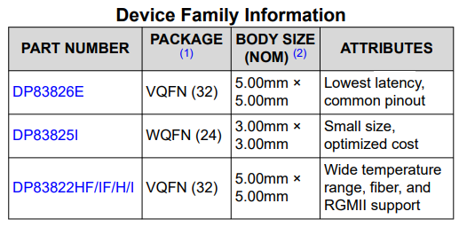

  • Hi Christopher,
    The advantages of DP83826 vs DP83825 are mentioned in their datasheets under 'Device Family Information'. Furthermore DP83825 does not support a MII MAC interface while DP83826 does. DP83825 must use an RMII MAC interface.
    the 83826 setup can be run off of a 25MHz crystal and does not need configuration to work at 150M is that correct?
    Yes DP83826 can be run on a 25MHz crystal and can be enabled through hardware strapping. There is no requirement for software configuration if your hardware strap settings are correct.
    Also, which has better (longer distance) performance?
    I would recommend DP83826 for longer cable applications. From the datasheets, DP83825 has 'up to 150m' while DP83826 has '>150m' of cable reach.

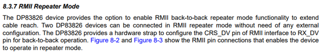

    is there reference design showing back-to-back operation?
    I'm not aware of any reference designs that use DP83826 in a back to back configuration. We do have our DP83826EVM that can help with the MDI-side implementation. If you've got a 150m cable already, it could be a good idea to test with the DP83826EVM as a proof of concept.
