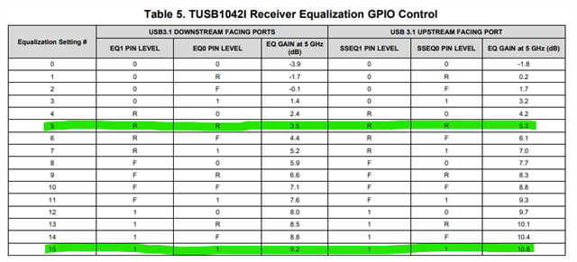

    This looks to be an EQ issue. The link probably finished enumeration by seeing the appropriate terminations, but the signa quality itself is poor, so the link drops. What is the EQ value used currently?
    We have tried the full range of resistor settings for EQ.
    Are you able to send an eye diagram for the output waveforms at EQ setting 0, 8, and 15?
    There are 2 sets of EQ in the TUSB1042. We have the SSEQ0/1 (upstream), and EQ0/1 (downstream). Can you share what the values are currently when testing?

    Currently during testing, EQ settings are set this way:
    SSEQ0, SSEQ1, EQ_0, EQ_1 all tied to 3.3V through a zero ohm resistor.

    This level of equalization most likely too much for what the system needs. This could be the reason why the camera enumerates, but the USB data link fails.
    I understand you tested some different EQ configurations before, do you have any info of which ones?
    Were you able to test with the TUSB1042EVM? The EVM has jumpers on the GPIO control pins meaning we can cycle through the EQ settings without having to solder resistors. Testing with the EVM could give us a rough estimate for the EQ needed in your system, and we can tune accordingly.

    I have tested SSEQ0, SSEQ1, EQ_0, EQ_1 all tied to GND through a 20k resistor. I have not tested any other settings that I have notes for. Soldering resistors is fine for me, the Eval board requires an uncommon cable we don't have.
  • Ok, so the only EQ settings we have tested are as follows. Is this correct?
    When tuning EQ, I recommend using the loss of the system to try to approximate the compensation needed.
    Example)
    The pre-channel loss will be compensated by the SSEQ0/1, and the post-channel portion will be compensated by EQ0/1. We will need to tune these independently based off of the respective losses.
    Are you able to estimate the pre and post channel posses?
    For PCB traces at 5Gbps the loss is approx. 0.5dB per inch.

    This is correct. Firmware engineer is testing the board with a new cable and having better camera feed results
    Is this on the board only? These numbers are for PCB only.
    Prechannel ~1.1dB
    Post Channel ~.58dB
    This imples the issue is with signal quality rather than routing. We should be able to tune this system.

    About how long are the cables used? Do we have an estimation of the loss of the cables?
    I would try the following settings based off of the losses provided. I will assume 3dB of loss per cable.
