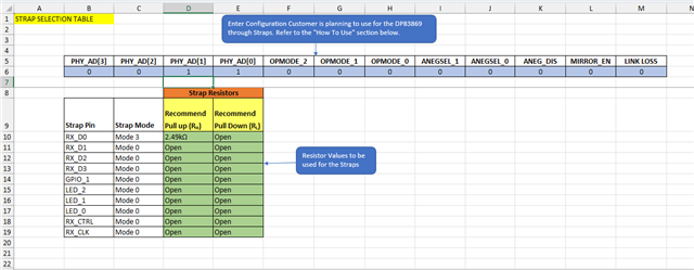

Strapping settings for the PHY from the Excel 3324.DP83869_Schematic_Design_Review_Checklist.xlsx worksheet:

PHY STRAP_STS                  (0x006E) = 0x0030 = 0000_0000_0011_0000
												   Bits 15:14 = 0 -> Reserved
												   Bit  13    = 0 -> STRAP_LINK_LOSS_PASS_THRU -> Enable
												   Bit  12    = 0 -> STRAP_MIRROR_EN -> Disable
												   Bits 11:9  = 000 -> STRAP_OPMODE -> RGMII to Copper
												   Bits 8:4   = 0_0011 -> STRAP_PHY_ADD -> 0x3
												   Bits 3:2   = 00 -> STRAP_ANEGSEL -> Default
												   Bit  1     = 0 -> STRAP_ANEG_EN -> Disable
												   Bit  0     = 0 -> Reserved

There is a connection to a switch between the Linux test laptop and the embedded platform.  The link status does reflect the current setup of the embedded platform (100Mb/s or 1Gb/s depending on what mode we are trying to test - indicates that auto-negotiation seems to be working).  Note: when performing the external loopback test for the PHY, we disconnect from the switch and use a loopback dongle as shown in the PHY datasheet.

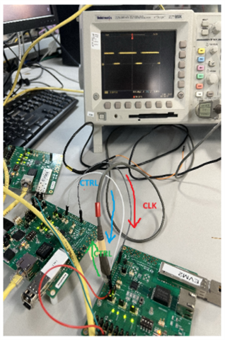

  • Hi Jim,
    I did a 1000Mbps MII loopback test on the TX_CTRL --> RX_CTRL signal with our DP83869EVM in the lab. I am able to see the RX_CTRL signal coming out of the device with the setup below (Right-side EVM is in MII loopback):
    In order to get a signal out, the 125MHz clock needs to be present on the GTX_CLK pin of the PHY. To put the right side EVM in loopback mode, I wrote 0x4140 to register 0x0000. Can you confirm the clock is present on GTX_CLK? Without this, I imagine no data would return from the PHY.
    • If you can show a waveform of TX_CLK, TX_CTRL, and RX_CTRL near the PHY that would help to see.
    Shane
