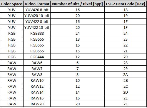

  • Hi Gong bin,
    DVP data received by the 933 can be probed directly from the imager output. It's not very helpful to probe FPD encoded data from the 933 output. There are several error/status registers on the 960 which can be checked for any issues.
    I see in register 0x0c that RX port 1 is enabled. Can you confirm the 933 is connected to RX port 1?
    I see register 0x4c=0x00 which indicates register reads target RX port 0 register set. I see 0x4d=0x00 indicating no lock and 0x4e=0x02 indicating no FPD clock detected. This makes sense if no serializer is connected to RX port 0. Unfortunately I can't really check configuration or status from this register dump since the incorrect RX port is selected.
    Can you share the following information with me to assist with debug?
    • What are the video parameters of the imager you are using? What is the video format used?
    • Can you share your initialization script for both the 960 and the 933? I'd like to review.
    • After initialization is complete, can you repeatedly read the following error/status registers at a 1sec interval? It'll be helpful to understand if any errors occur continuously or in short bursts.
      • 960: First write 0x4c=0x12 to select RX port 1. Read 0x4d, 0x4e, 0x55, 0x56, 0x73-76, 0x7a, 0x7b, 0x90-0x9f.
      • 933: Read 0x0a-0x0c.

  • Hi Lucas
    thank you for your reply.
    about your question, my answer is below:
    1. What are the video parameters of the imager you are using? What is the video format used?
    DVP formatits pclk is:27M, FPD_Link iii Capture format is Raw12LF
    2. Can you share your initialization script for both the 960 and the 933?
    → my initialization script is below, and i make sure the 960 RX1 is connect to 933

  • Hi Gong bin,
    Thank you for your detailed reply.
    Your register read indicates several errors in register 0x4E on the first readback. Note that this is expected as many errors can be flagged during initialization. The first readback clears these errors.
    After the first readback, there are no errors flagged in 960 or 933 registers. 960 register 0x4D=0x41 indicates there is stable lock, however the receiver input does not meet PASS criteria. I see in your configuration that register 0x7D=0x03, meaning PASS is only asserted after 3 valid frames are received. Can you try changing this to 0x7D=0x00 to see if this resolves the issue?
    Counters in registers 0x73-0x76 indicate that there are 25 lines/frame and 3 bytes/line detected by the 960 RX port. These values seem incorrect for a typical imager. What imager are you using and how is it connected to the 933EVM? Can you double check the imager configuration is correct?
    I see in your configuration 0x71=0x2C, meaning the 960 will decode input data as RAW12 format. Can you confirm if this is the correct video format? The value will need to be changed if a different format is used.
    Does your imager use embedded lines? If it does, the configuration in register 0x4B may need to be changed.
    Lucas
