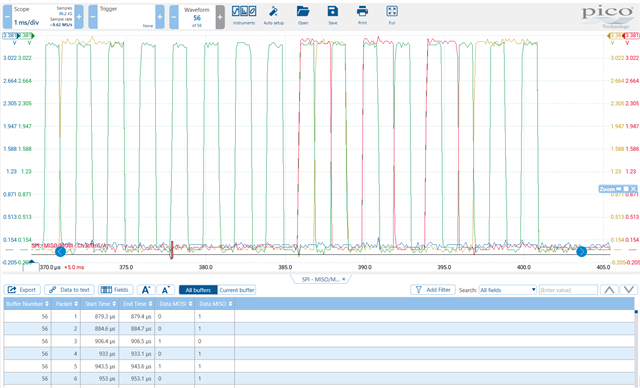

    Green is Clock, Red - SDI , Yellow - SDO, Blue - CS
                          In the above screenshot , in between blue line is the CS Pin made high and low. After that i tried to send the consecutive commands of
    register read like 0x04, 0x51 , 0x52, 0x53, 0x54, 0x55 , between the each of these register read i given delay of 500US which is mentioned code

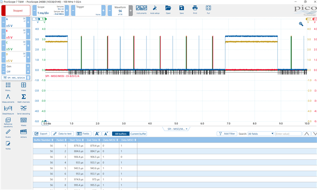

  • One Screenshot got missed , i am attaching here

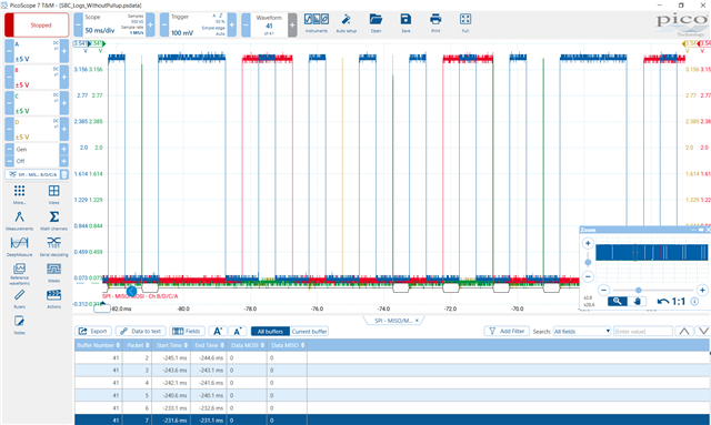

    So while we checked the other board without pull up resistors, clock, SDI and SDO cannot able to get proper signal. So whether external pull up resistor actually required.
    In new board Clock is pulled up with 100k resistor
    While we are sending data, SDI lines (red) cannot able to see properly in data communication, i am attaching one of sample of SDI data miss.
    Blue - CS, Red - SDI, Green - Clock, Yellow - SDO
    Sometimes Clocks are missing, even though we have externally pulled with 100k

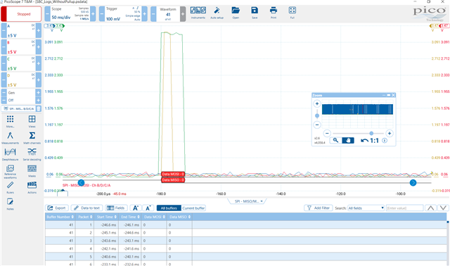

    In one of the case of read request of interrupt register (0x55), i can see the SDI line with below attached one
    By this, if i collect and send my observation of data whatever u requested it will be completely improper. So can you try to recheck once the schematic design and post your observation, whether any pull up resistor required for these lines or not.

    You don't need pull-ups on the SPI lines. You may need a pull-up on the nCS pin if the controllers nCS pin is open drain/open collector - but the SBC does not require you to add pull ups on the SPI lines.
    It is recommended to have a pull-up to VCC1 on SW pin during initial debug to prevent device from restarting due to missed watchdog triggers - after watchdog triggers have been implemented this pull-up isn't needed anymore.
    The SCLK, SDI signals are coming from whatever controller/tool you are using - if they are missing clock signals or are not sending proper SDI signal configuration that is not the SBC that is causing issues. I can't debug the SPI tool/controller you are using - but the SPI signals are invalid so I can't debug the issues until you are able to generate correct SCLK and SDI pulses consistently as I am not able to help you debug the SPI issues.
