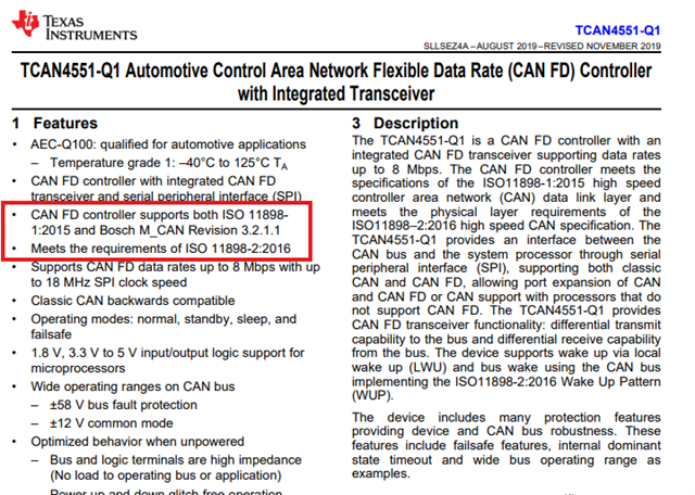

    As stated in the datasheet, the TCAN4551-Q1 follows the ISO 11898-1:2015, ISO 11898-2:2016, and Bosch M_CAN Revision 3.2.1.1 specifications.

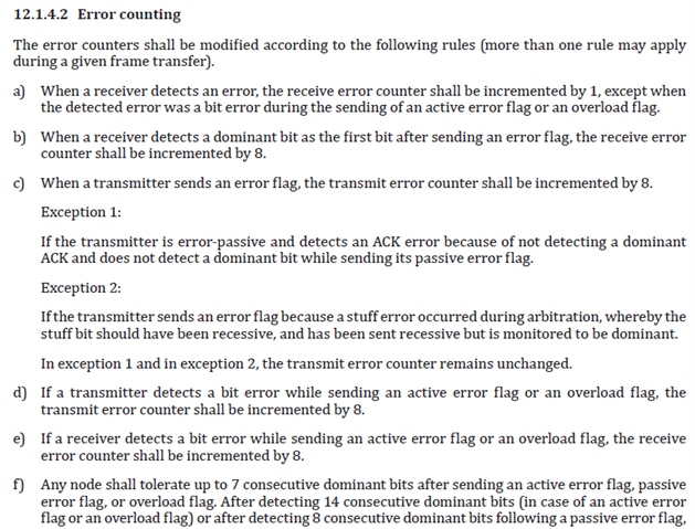

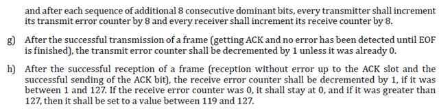

    The ISO 11898-1 Standard defines the error counting and there are a couple of exceptions that would prevent the TEC error counter from causing a Bus Off condition, particularly when there is not another device to send an ACK which would occur when there is only one device used during testing.  Two devices are needed.
    Because the TCAN4551 uses the Bosch M_CAN IP for the CAN FD Controller, you may also want to reference the M_CAN User's Manual (Link) for more detailed information.
