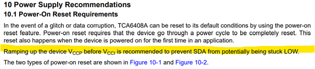

  • Hi Tyler,
    May I ask — in my current circuit, both VCCP and VCCI are connected to the same 1.8 V rail, meaning their power-up timing will be exactly the same. Could this cause any potential issues?
    If so, would it be possible to recover by toggling /RST?
    On the other hand, if the /INT function is not required, can it be left floating, or does it still need a pull-up resistor?
  • Hi Richard,
    A potential problem of SDA being stuck LOW is only possible if VCCI comes up before VCCP.
    If SDA gets stuck LOW, you would need to cycle the VCCP and VCCI pins in the correct order.
    /INT can be left floating if unused. No need for PU resistor.
