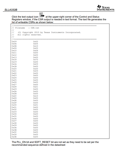

    I noticed in the programming guide, it is able to produce a flat log that includes the register programming, you can see that here:
    Have you referenced the necessary CSR registers that need to be programmed for this application and referenced this bring up application to determine if they're configured correctly? There is also an example initialization script in our data sheet:
    Please let me know if you have any additional details about how the device is interfaced with, is there configuration available through discrete I2C transactions?
