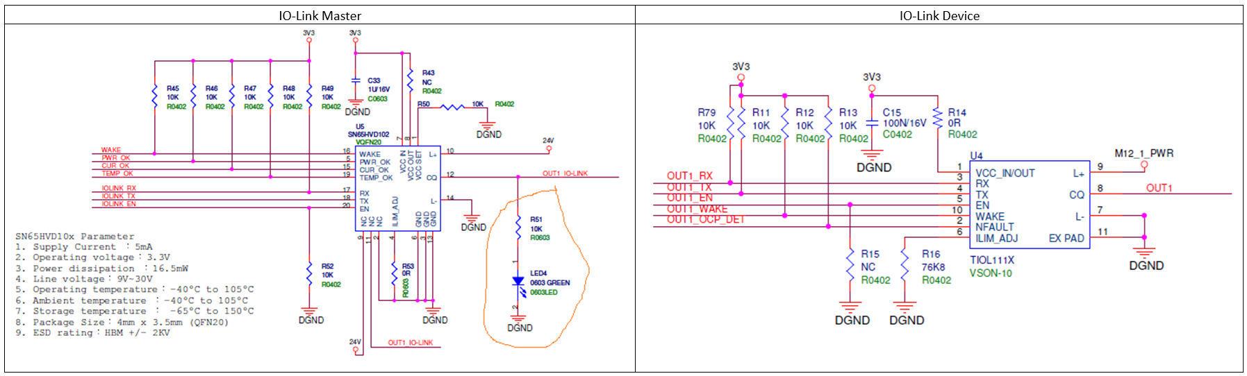

Hi Team,
Please help to check the issue.
The schedmatics as below.
If R51 and LED4 existing, the communication is OK. However, removing R51 and LED4 will cause the communication fail.
May I have your comments about it.
