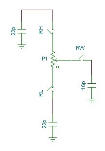

    B) I wish I could use a differential topology: unfortunately I have a single-ended input and a single-ended ADC input (ADC12 in MSP430). I had in mind to do like you suggest for option O2 (also to be almost immune to the +/-20% tolerance), however I am still concerned that even 2 switches in parallel will give me some distortion with a 3Vpp voltage swing at the output, also considering I need -80dB THD. As I cannot simulate and test it (at the moment), could you please roughly quantify the distortion I should expect in such case?

    D) Could you please provide me with a more accurate macromodel than in the datasheet? More in detail, where/how are the CMOS switches placed exactly? Can you post a rough schematic drawing please? That would help as I can try to place most switches on the virtual ground where there should be barely signal.

    I tried taking a look at the distortion introduced when the dpots are used in feedback configuration with a couple sims and it looks like the effect of the switch resistance variation has very strong impact on the overall gain function and hence the distortion ends up being significantly magnified (compared to when the dpot is used as a voltage divider).  I don't think that this approach will be sufficient for your needs.
    Something else that you might try is using the amplifer as a fixed gain stage w/ discrete resistors and then using the dpot at the input of this gain stage as a voltage divider to attenuate the signal as necessary.  Your -80dB THD requirement will definitely still be a challenge, but I think that you may get very close.  The spec that we have on our datasheet is actually a THD+N measurement using a 80kHz bandwidth and so that number is a bit pessimistic if you're concerned w/ the distortion only.  To give you feel for the distortion levels to expect, my sims are showing that the THD alone is on the order of 0.005%.
    Finally, I've attached a figure showing you how the switches are connected to the dpot terminals and a plot of the switch resistance variation with voltage (plot from TPL0202 datasheet).
