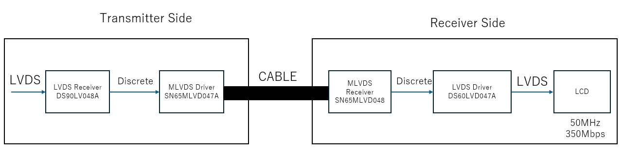

I would like to transmit LVDS signals for LCD. (50MHz, 350Mbps)
For longer transmission, we would like to use MLVDS instead of LVDS.
I am considering structures shown below.
(Q1) For transmitter side, MLVDS driver seems to support discrete input.
        Should LVDS convert to discrete signal by LVDS receiver?
(Q2) For receiver side, MLVDS receiver seems to support discrete output.
       Should discrete signal convert to LVDS by LVDS driver?
(Q3) I would like to transmit  LCD signal.  LVDS clock is 50MHz and date rate is 350Mbps.
         But, MLVDS driver(SN65MLVD047A) and MLVDS receiver(SN65MLVD048) support  200Mbps-250Mbps.
         It seems that MLVDS transmission length is up to 50m.
         Our requirements for transmission length is 15m. Is there any possibility to support 350Mbps and 15ms?
