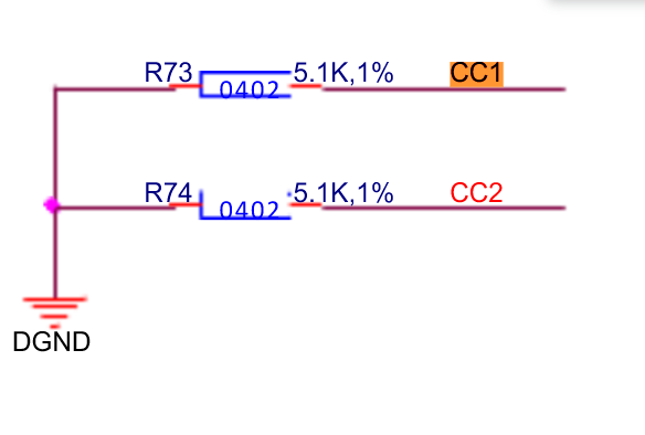

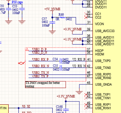

Hello, we first wanted to make 2 USB3.0 ports with a USB3.0 port of the RPI-5 with the TUSB8020BPHPR hub. Afterwards, we used one of the USB3.0 outputs directly. We converted the other one to PCIe lines with the USB to NVMe converter RTL9210B. The first output works as 3.0, but the lines connected to the RTL9210B are seen as USB2.0. The necessary .bin file was added to RLT. What could cause the error? Aren't both TUSB8020BPHPR outputs USB3.0?
