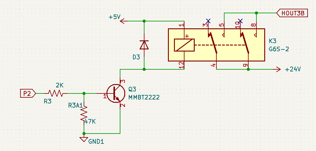

Hello, i have a custom pcb with an arrange as follows
p2 is a PCF8574 pin.
when put in HIGH a voltage about 0,75V is read betwen R3 left side and GND. Not enough to activate MMBT2222.
can be this fixed removing R3A1?
any advice will be apreciated.
Br
Juan

  • Hi Juan,
    PCF8574 has a weak pull-up FET. Its IOH is between 30 uA and 310 uA.
    The resistive divider circuit looks to source 5 V / (47000 + 2000) = ~102 uA.
    This might be the reason why when you decide to drive HIGH you only read a voltage of 0.75V. Consider using an I/O expander with stronger PU drivers such as the TCAL6416PWR. Its IOH can drive several mA.
    Tyler

  • Hi Juan,
    So from my understanding of the datasheet, the range of base-to-emitter saturation voltages can be 1.2 V to 2 V max.
    The output high voltage of PCF8574 may just barely be reaching the acceptable range of VBE with its output high voltage.
    Removing the 47k to GND would eliminate that excess current leakage path. You might also try reducing the 2k gate resistor to something less, 500 ohms, to see if this improves the VOH at the gate.

  • I will respond soon.
  • Hi Juan,
    During power up only P1 is high until is put LOW by software. If and actuator is controlled by this pin this will be out of control a few seconds.
    The PCF8574 device powers on with a weak PU source to VCC. It is about 100 uA of current strength. This would be equivalent to 10's of kohm of PU strength. Each IO powers up this way.
    This 100 uA current source can be overcome by sinking current externally from a device. This is how the IO is driven LOW by some device elsewhere in the system.
    I would say this is expected behavior is you can determine ~ how much current is being sunk on each pin externally. If you need a stronger pull-high to VCC, consider adding external pull-up resistance to keep the IO at a stronger logic high state.
    Tyler
