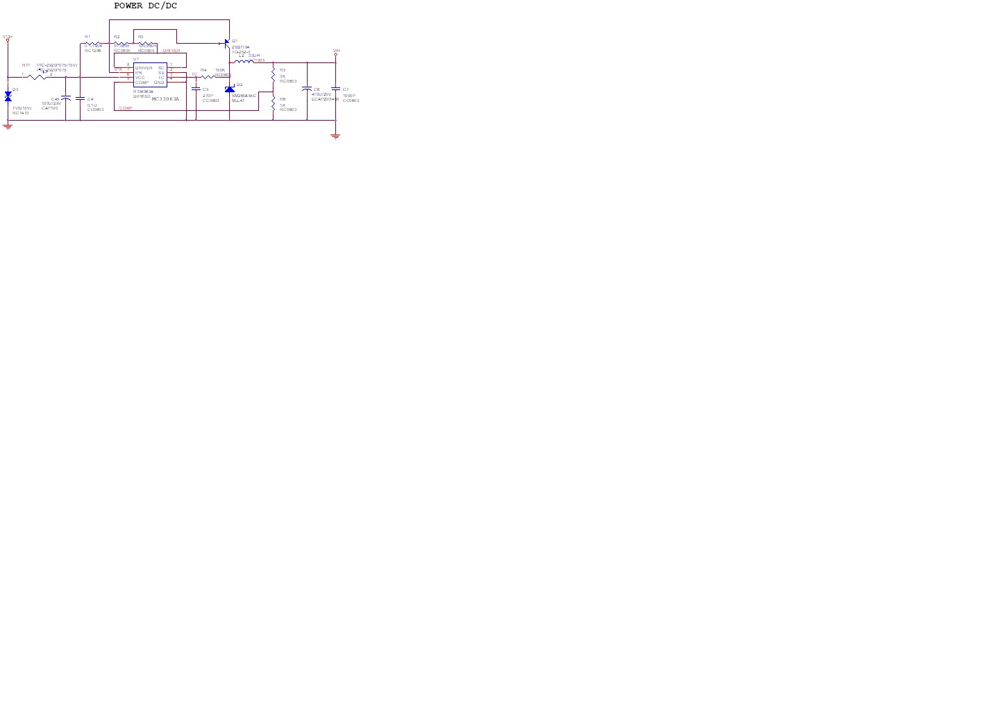

1.Are there different L/C in the same reel? (OAETD + OATEN )
2.The test waveforms of normal and abnormal products are as follows

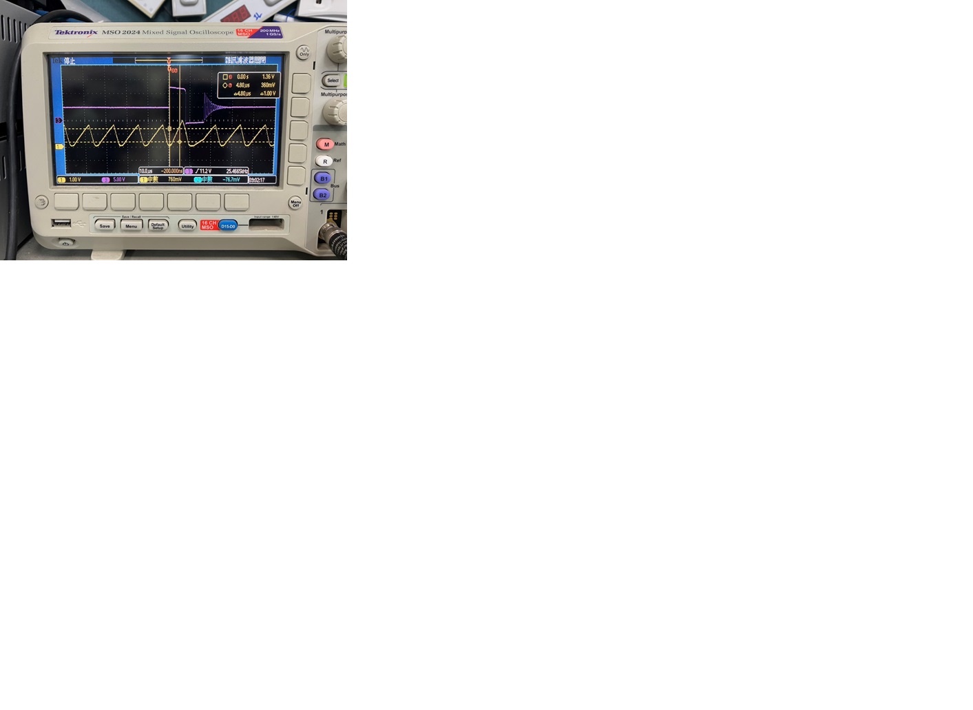

Input 12V; L2 ON period measured about 5usec; ​​TC measurement, amplitude/period stable.
D/C TI53M

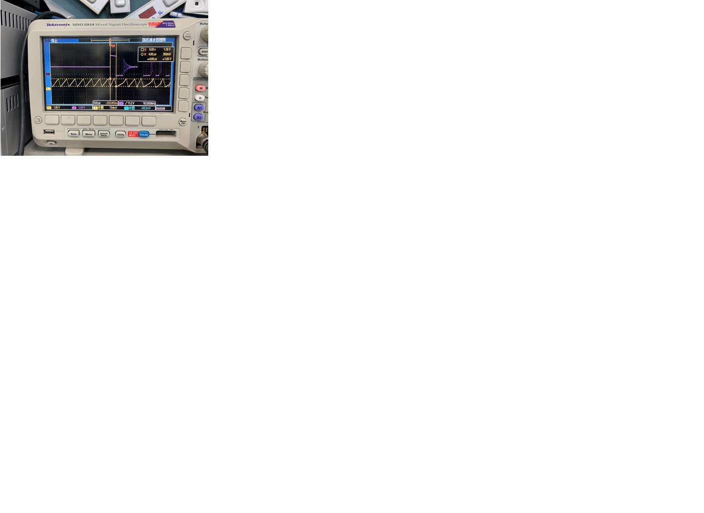

Abnormal Item:TI52M AETN
When inputting 12V, the TC test point is abnormal, with large amplitude and period. Furthermore, the Q1 ON period is unstable.
What causes cycle instability?

    I am sorry, but I do not understand what you are seeing as issue. Can you please explain why you have a resistor from the switch node to the TC pin? Please check if the behavior changes when you remove this resistor.
