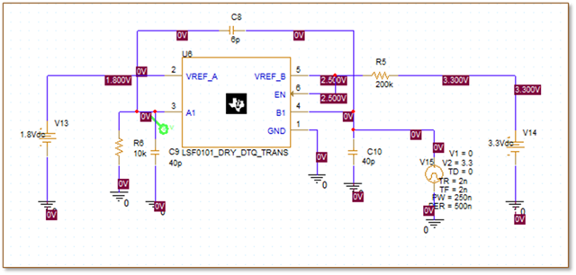

In our customer's 3.3 V to 1.8 V conversion line, overshoot that did not occur in the prototype occurred in the second prototype.The left is the signal waveform with no problem, and the right is the waveform with overshoot.
The phenomenon follows LSF0108. Also, there is a difference in marking between these devices.
1) What is the difference between them?
2) Please tell me the specific cause and countermeasures.We, the distributor, conducted a simulation and found that there is a difference due to capacity. For this phenomenon, the peak voltage is lowered by placing a series resistor, but the constant cannot be determined.
3) Is this understanding correct? Is the countermeasure for this problem to place a series resistor as a way to suppress the rise time? If so, what is the constant of the resistor?
4) Please let me know if there is another countermeasure.

    Overshoot cannot be improved unless the rise time is set to 200 ns during simulation.
    To obtain the transition time of 200 ns, I think it is determined by the time constant of series resistance and Ci.
    Therefore, if Ci inside the IC is not specified, the constant of series resistance cannot be determined.
    1) Please tell me how to determine the constant of series resistance.
    2) Ci is stated as 40 pF in the data sheet. Please tell me how much variation there is and its σΣ value.
    3) What is the relationship between Cin and Con? The data sheet describes Ci and Cio (On) as follows.
    Isn't it wrong that the value of Cio (On) is lower than Ci (EN)?
    Please tell me the correct value.
    When determining the series resistance constant, I think it would be confusing if the value of Ci is wrong.

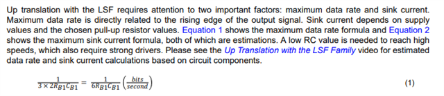

  • Hi Ryusuke-san,
    The output transition rate is dependent on the RC time constant formed by the external pullups and capacitive load associated with the output. This formula provide in the datasheet can be used as a reference to estimate what is the max achievable data rate given these external conditions:
    The Cio parameter you have pointed out is providing the detail of the capacitance of the switch itself. Cload (output capacitance) would play a much bigger role here in the output transition rate.

    This incident was confirmed only in the down conversion line from 3.3 V to 1.8 V.
    What is expressed as overshoot is the waveform appearing at the rising edge.
    I understood that it is important to check the output capacitance Cloud during down conversion, and Cio is a value to be ignored for Cloud.
    Specifically, how many Ω of series resistor is required for how many F of Cloud?
    It is necessary to completely suppress overshoot for the input terminal capacitance.
    I send the simulation result with Ci=40 pF referring to the data sheet.
    When the rise time of the input waveform was changed from 2 ns→100 ns→200 ns, we thought that overshoot could be avoided at 200 ns.
    In order to make the rise time more than 200 ns by using a series resistor, we confirmed that about 1 kΩ is necessary from the relationship between the resistance value and the rise time.
    This is on the assumption that Ci=40 pF (typ). Therefore, we think that overshoot may occur when Ci is small.
    Do you have any information about the variation of Ci?
    I am sorry, but I am in a hurry to answer. I would appreciate it if you could answer tomorrow.
    Ryusuke

  • Hi Ryusuke-san,
    Unfortunately the variation for the CIO parameter is only what has been detailed in the datasheet. The series resistor value implementation would require the evaluation of different values as there is not a standard procedure to finding this value per your setup. The use of pullups on the output (1V8 side) would also help to maintain logic high state of 1V8 and reduce the overshoot. (Please note pulldowns are not recommended to be used with this device).
    Additionally, I would suggest evaluating the device with the EVM: www.ti.com/.../slvub53.pdf
    Jack

  • Hi Ryusuke-san,
    CIO on/off refers to the capacitance at the I/O terminal of the device with the input condition that establishes the high-Z state at the output. In other words, this parameter is the internal capacitance encountered at an input/output (I/O) of the device.
    The spec you referred to at Ci (EN) is higher then CIO because this is the capacitance at the gate of the internal FET of the device. IT should not be factored in your calculations as it is not the capacitance associated to the I/O port.
