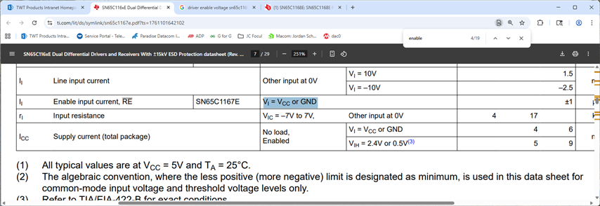

    How about the statement below about the enable input, the test condition was Vcc, 5V.
    Jordan
  • Hi Jordan,
    For that screenshot, VCC is tested as an upper limit for the current spec, but 2V is still the threshold. 3.3V will be just fine for the enable pins.

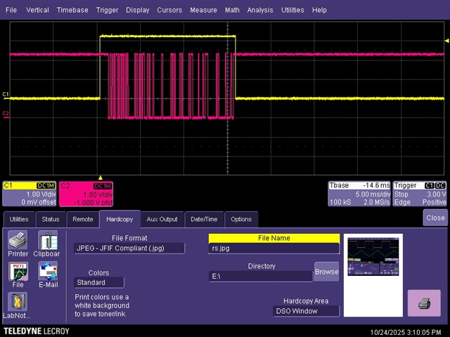

    Enable and data toggling in sync
  • Hi Jordan,
    Thanks for sharing those images. Please keep me updated on the rest of your testing.
    Additionally, are you able to confirm transmitting/receiving with other SN65C1168E transceivers or other boards?
