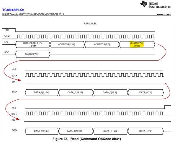

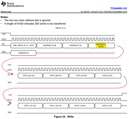

  • Hi Roy,
    The TCAN45xx Software User's Guide (Link) provides examples of how to configure the MRAM and to optimize the SPI communication.
    The burst mode/ bulk read at the SPI driver level is changing the Length field of the SPI message header to indicate how many words of data will be transferred before the chip select signal is pulled high.
    The datasheet SPI Write and Read diagrams already show a 2-word write with the Length field set to 2.  If you notice there is a total of 8 data bytes transferred which is equivalent to 2 words of data. Each word is equal to 4 bytes or 32-bits.
    The Address field is then the "Starting Address" of the first word of data to be transferred.  One example of this in use is to read the entire contents of a Received CAN message from the MRAM buffer element.  You would simply provide the starting address of the RX buffer element and how many total words of data the buffer holds.  As long as the MCU provides the correct number of SPI clock cycles and holds the chip select line low for the entire transaction, there is no need to perform multiple SPI reads to receive that message.
    Likewise you could write the entire contents of a CAN message to a TX buffer element in a single SPI Write transaction.
    Jonathan

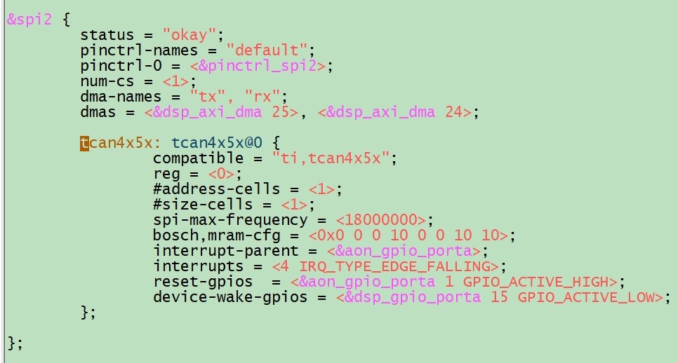

    We have confirmed that SPI read and write operations are using burst mode, and the DTS configuration is as follows:
    &spi2 {
    status = "okay";
    pinctrl-names = "default";
    pinctrl-0 = <&pinctrl_spi2>;
    num-cs = <1>;
    dma-names = "tx", "rx";
    dmas = <&axi_dmac 25>, <&axi_dmac 24>;
    tcan4x5x: tcan4x5x@0 {
    compatible = "ti,tcan4x5x";
    reg = <0>;
    #address-cells = <1>;
    #size-cells = <1>;
    spi-max-frequency = <18000000>;
    bosch,mram-cfg = <0x0 0 0 10 0 0 10 10>;
    interrupt-parent = <&aon_gpio_porta>;
    interrupts = <4 IRQ_TYPE_EDGE_FALLING>;
    Is the "mram-cfg" configuration reasonable, and can it be further optimized for high-bandwidth requirements?

  • Hi Roy,
    You are allocating the following:
    SID Filter Elements = 0
    XID Filter Elements = 0
    RX FIFO 0 Elements = 10
    RX FIFO 1 Elements = 0
    RX Buffer Elements = 0
    TX Event FIFO Elements = 10
    TX FIFO Buffer Elements = 10
    I'm not sure of your system application requirements, but here are a few basic comments for thought.
    The overall SPI transfer rate is the primary limitation to the maximum CAN message throughput regardless of the MRAM configuration.
    Increasing the number of elements in RX FIFO 0 may help add some margin if your CAN messages come in bursts.  However, this won't help much if the messages are received at a consistent rate which is faster than the SPI transfer time.  It will just take longer to fill up the FIFO but will still eventually overflow.
    There are no SID or XID filter elements configured so EVERY CAN message will be stored into the RX FIFO.  If there are CAN messages on the bus that you do not care about, and you only care about receiving particular CAN messages, then you should set up the appropriate filter elements so that unwanted CAN messages are not stored into the RX FIFO.  This will ensure that only the CAN messages you care about are having to be serviced through SPI and unwanted CAN messages don't take up unnecessary bandwidth.
    I see there are 10 TX Event FIFO elements.  If you are not using or need to track every TX Event, then you may consider not using the TX Event FIFO.  This FIFO requires additional SPI Read and Write transactions to monitor, acknowledge, and clear the TX Event elements.  Reducing any unnecessary SPI transactions will provide more time for the processor to service actual CAN messages.
    If your TX messages have data or values that do not change, then you may consider using dedicated TX buffers that would allow you to avoid writing the same message data into the TX buffer every time you want to transmit the message.  The TX buffer elements are not cleared after the message has been transmitted, so it is possible to re-send the same message repeatedly by just setting the TX Buffer Add Request bit for that buffer element every time you want to send the message.  This may be a method to reduce the overall amount of SPI data.
    I can't determine if you are using TX FIFO, Queue, or dedicated TX Buffers, but you can use a mix of TX FIFO/Queue and Dedicated TX Buffer elements.  See the M_CAN User's Manual for more information (Link).

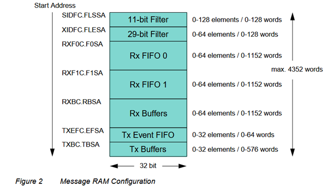

  • We would like to make the number of RX FIFO 0 Elements as large as possible.
    How should we configure it, and what is the maximum value that we can set for RX FIFO 0 Elements?
  • HI Roy,
    I would suggest reviewing the TCAN45xx Software User's Guide (Link) which discusses the MRAM allocation of elements.
    The TCAN4551 only has 2kb of total MRAM space to use for all of the different element types.  The amount of data bytes allocated for each of the RX and TX message buffers also needs to be configured.  You can have more RX message buffers if you don't need to support the maximum 64-byte data payload.  However, this is application specific, so you need to set the buffer data size to meet the maximum message size you will need to support.
    I will note that the MRAM configuration is completely customizable for your application and you can use as many or as few of the different element types as your application requires as long as the total configuration fits within the 2kb space.  You can have more RX elements and fewer TX elements, or more TX elements and fewer RX elements.  The number and type of RX Message SID and XID FIlter Elements is also something you need to consider along with whether you need to use the TX Event FIFO.  You are not required to configure elements you do not intend to use.
    As a result I will note that the MCAN configuration will support more elements than there is MRAM space, so you simply can't set the maximum value of all the elements and expect it to fit within 2kb.  But you can find the following list of the configurable size of the different element types in the MCAN User's Manual (Link).
    Jonathan
