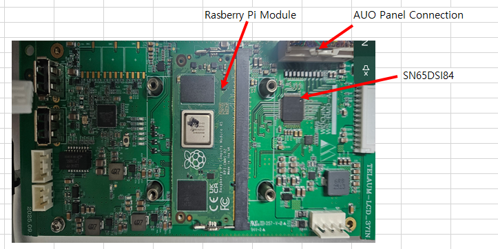

  1. Problem 1 : The LCD screen turns on normally, but then turns off and then turns on again when U12's 2Pin goes low.
  2. Problem 2 :
    When I input 22.5MHz to a 37-inch LCD, the screen turns on (similar to Problem 1).
     When I input 45MHz to a 37-inch LCD, the screen doesn't turn on.
    3. signal sequence
    Raspberry Pi(DSI) => TI SN65DSI84-Q1 (LVDS) => 37Inch LCD

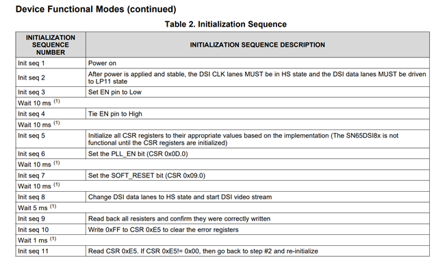

  • Hi Park,
    The Pin 2 EN pin is used to enable/ disable the device. So this is expected that the device will reset/shutdown when EN is low. Please follow the initialization sequence shown in the datasheet "8.4.2 Initialization Sequence" section.

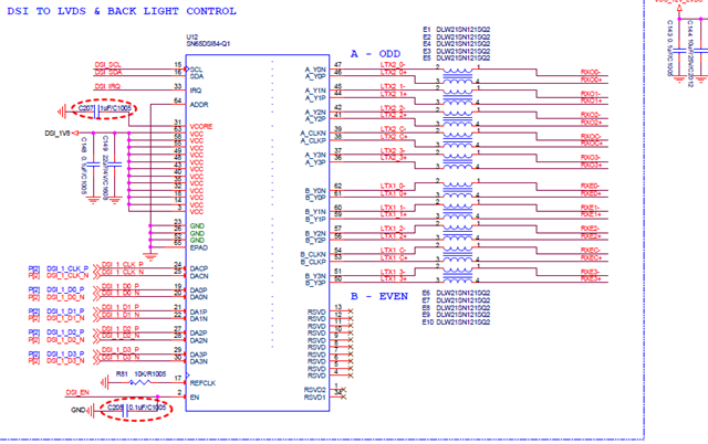

  • 8182.cm4s(Raspberry).pdf1.The LCD screen flickering issue has not been resolved yet. The LCD screen turns on normally, then turns off and then turns back on irregularly.
    To solve this problem, do I need to add a separate clock as shown in the attached circuit? Is there no way to solve it through programming?
    If possible, I'd like to achieve the fastest and most complete solution possible, without requiring any circuit changes.
    Raspberry Pi(CM4S / DSI) => TI SN65DSI84-Q1 (LVDS) => 37Inch LCD(1920 x 540 AUO)
     LCD_37IN_LVDS_30PIN_V1_20250908(Before).pdfLCD_37IN_LVDS_30PIN_V1_20250908(After).pdf8524.LCD_37IN_LVDS_30PIN_V1_20250908.pdf

  • Hi Ikram
    1. The malfunction symptoms are as follows:
      1) After powering on, the screen turns on, then turns off (irregularly) and then turns back on.
      2) For gray-background screens, gray is displayed in a stepped pattern.
    2. I am currently testing using the attached circuit, "LCD_37IN_LVDS_30PIN_V1_20250908(Before).pdf."
       1) This circuit connects pin 17 (REFCLK) of the SN65SDI84-Q1 to GND with a 10kΩ resistor.
    3. I'm currently drawing the circuit diagram for "LCD_37IN_LVDS_30PIN_V1_20250908(After)".
       I'm planning to test this circuit by connecting an external REFCLK (OSC or Xtal) to pin 17 (REFCLK) of the SN65SDI84-Q1.
       The board configuration hasn't been completed yet. Please confirm that this circuit configuration is correct.

  • Hi IKram
    1. I'd like to test this by adding Y2 (27MHz/Crystal) and U100 components. Please confirm that this circuit configuration is correct.
    0676.LCD_37IN_LVDS_30PIN_V1_20250908(After).pdf

  • Hi Park,
    The REFCLK components and schematic is similar to the EVM, so this should be okay to use the REFCLK as the LVDS source here. note that depending on how is is used, the CDCEL clock synthesizer might need to be programmed via I2C.
    You could also try using the DSI clock as source. What is the source DSI clock rate set to?
    Could you please read register 0xE5 to see which errors are reported.
    Could you also check this please. The error checking register will help to narrow down the cause of this issue.
    Ikram

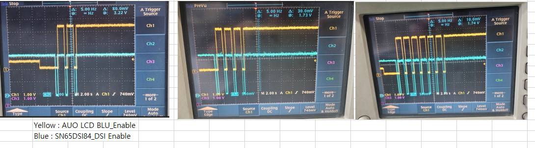

  • Hi IKram
    When the flicker occurs, the 0xE5 register is "01" as shown in the image below.
    Is there another register I need to check?
  • Hi Park,
    Could you share what DSI clock frequency rate is used and the whether the register settings match those rates?
    How is the DSI input connected to the device? Could you share what type of cable or connections are used?
    Ikram

    3. The oscilloscope waveform at the moment when the flicker occurs is as follows.
    4. The waveform immediately after powering on the set is as follows.
    5. I'm attaching the circuit diagram I'm currently testing.
    8015.P370IVN022-specification-12050527.pdf0167.LCD_37IN_LVDS_30PIN_V1_20250908.pdf
  • Hi Park,
    Please check whether the system is following the datasheet initialization sequence: "8.4.2 Initialization Sequence"
    - the power rails should be high and stable before EN is applied to DSI84
    - the input DSI clock should be in HS state before the devices in enabled (EN)
    - the DSI should only be in HS state. Is this how the output is currently set up?
    Ikram
