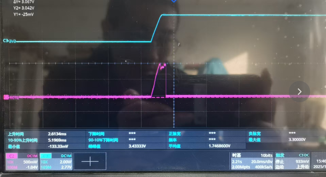

Using AM2732 as the main control and DP83867irrgzr as the phy, during the repeated power-on and power-off process, the PHY occasionally fails to connect. After our investigation, the most likely cause is that RX CTRL did not enter mode3. The pin of RX CTRL is pulled up to 3.3V at 5.76k and down to GND at 2.49k as per the manual. The power-on timing of RX CTRL and 3.3V that we tested did not meet the requirements either, but we were unable to determine the reason why the voltage divider level of RX CTRL could not be maintained. Please help us identify the cause together.
Blue is 3.3v and red is rxctrl

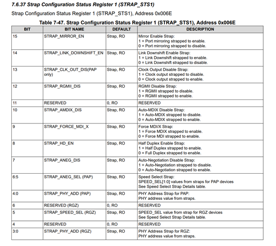

    Can you please read DP83867IR extended register 0x6E between the working and failing case? If RX_CTRL is not strapped correctly, then you should see a difference in bit 7 of register 0x6E?
    What is the VDDIO voltage, is it 3.3V? If the VDDIO is 3.3V, then at Mode 3, you should see a typical voltage of 0.8415V, with Vmin of 0.7425V, and max of 0.9372V. Looking at the scope waveform, it looks like we are violating the voltage threshold requirement.
    For the 5.76k and 2.49k strapping resistor, are you using 1% tolerance resistor?
    Does the MAC have internal pullup resistor? If the MAC has internal resistor, then we need to re-calculate the external strapping resistor value, please see this app note for more detail on how to calculate the resistor value.
