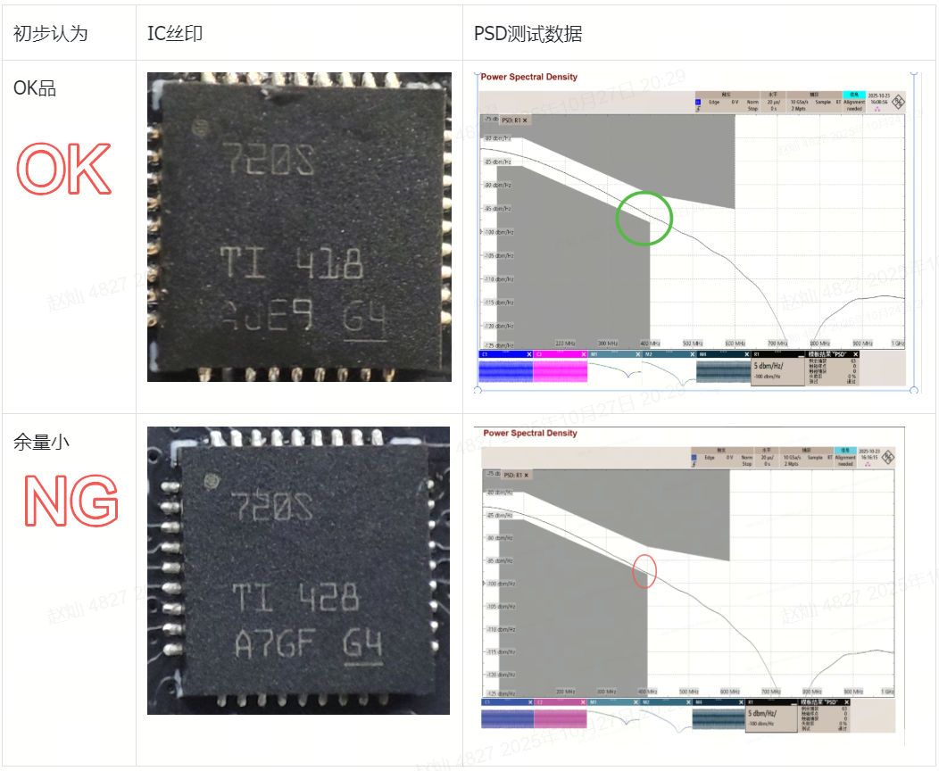

  • During ​PMA​ ​PSD​ testing, it was observed that the curve starts slightly lower (−83 dBm/Hz).
  • ​ICs​ from different ​batches​ exhibit inconsistent performance when populated on the same ​PCB.
  • Shorter traces perform better than longer ones; the marginal case fails at around ​400 MHz.image.png
