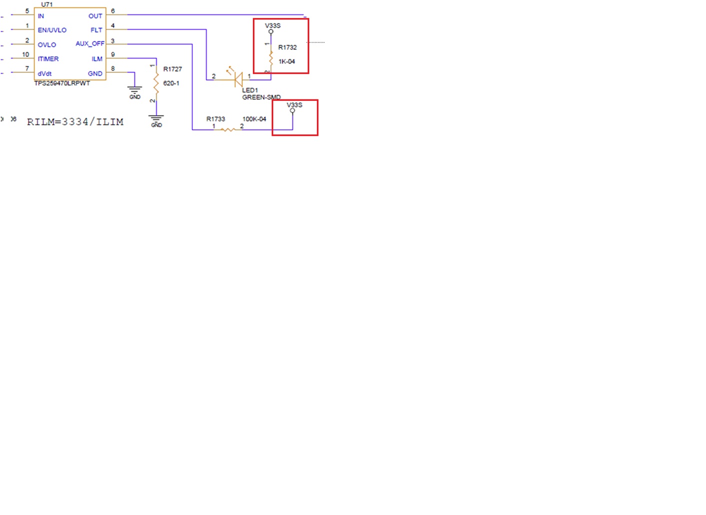

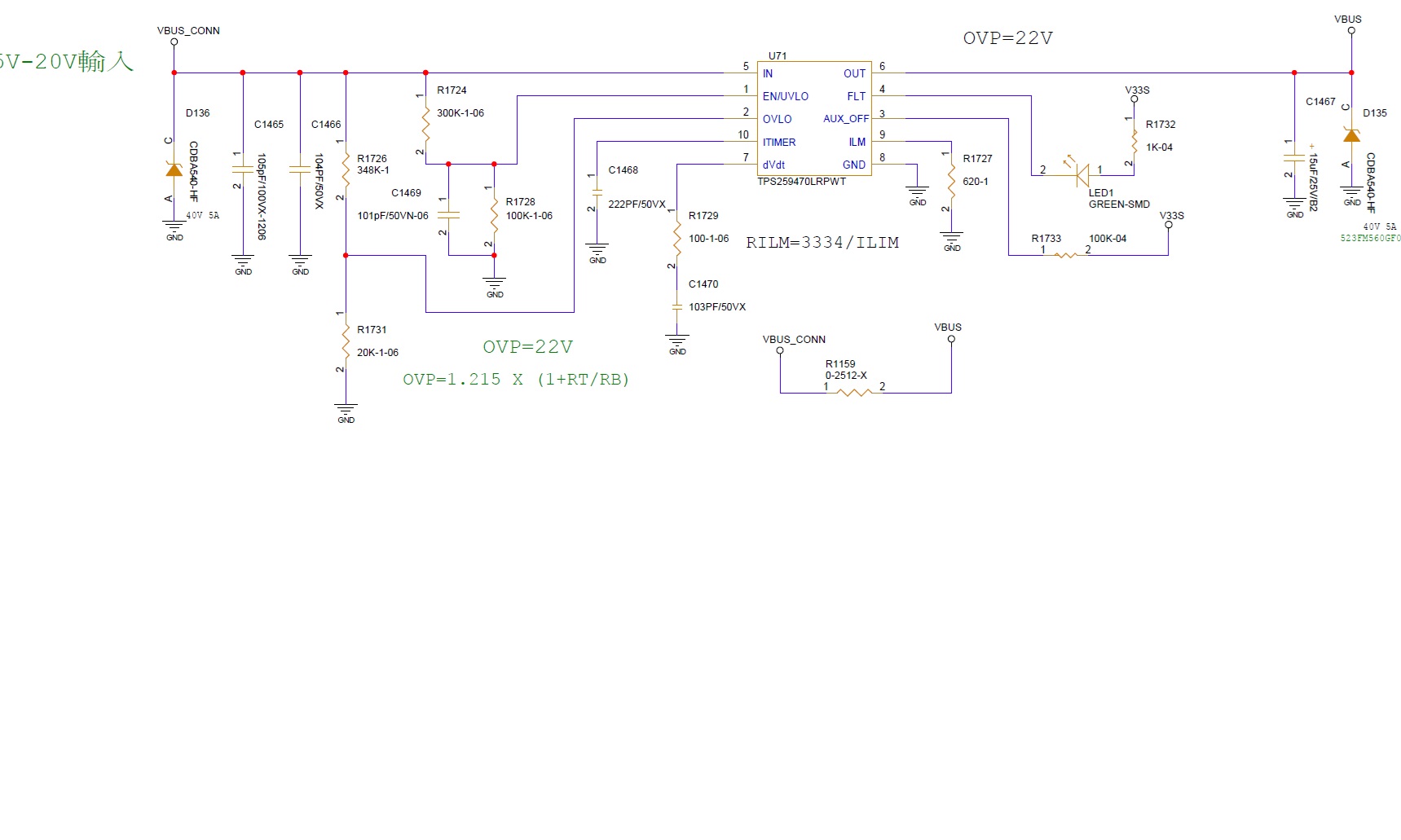

1.Could you help check the below TPS259470 schematic and any need to adjust
2. Because the system hasn't switched to 3.3V yet when Type-C is first connected, the V33S pull signal will only be generated after VBUS is sent to the system. Is this OK?
  • Hi Gareth
    The schematic looks fine
    I would suggest adding TVS diodes with breaking voltage just greater than absolute maximum of input pin
    I would suggest adding schottky diodes at the output
    Can you please elaborate on this
