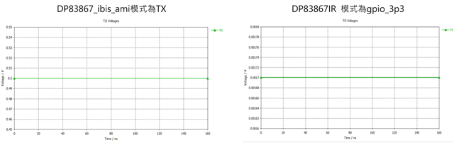

our customer download DP83867 IBIS model from below link,
they are using RGMII mode customer would like to know how to select below for EGMII mode?

Even though the model name says GPIO_SGMII_IN, you can still use TX_D0 and TX_D1 model for RGMII as well.

Hi David,
Can we provide example for RGMII model? customer follow our suggestion but still not able to get 125MHz signal. thanks.

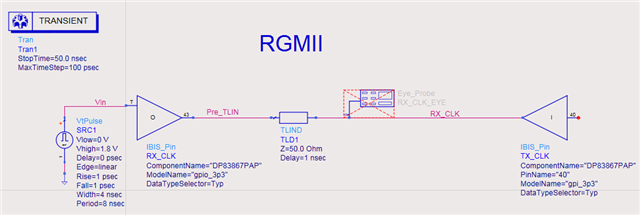

Hi Eddie,
I ran a simulation on the RX_CLK of this model in a back-to back example. I see the signal coming out of the pin with no issues.
This is my Keysight ADS schematic:
Here are the results I got:
Is your customer using keysight to simulate? If so, can they follow my schematic and see whether they get a signal?
