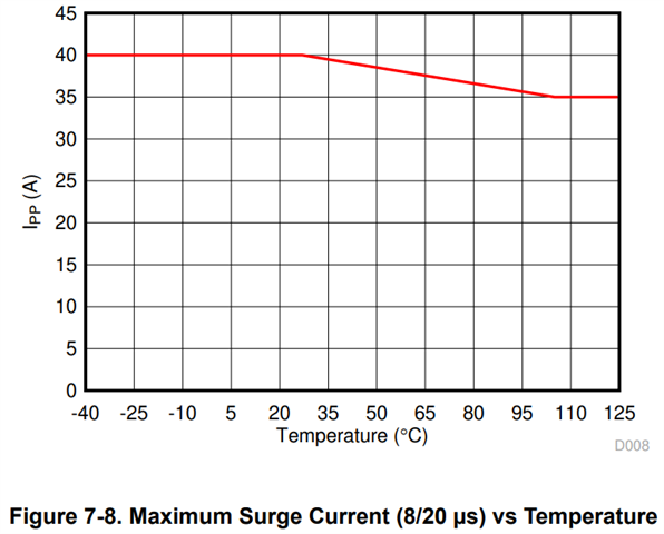

1) Is there a characteristic diagram showing the relationship between temperature and clamp voltage?

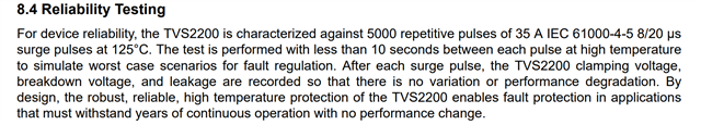

3) Is there a limit to the number of surges when used within the specified limits (e.g. 20A)?

    1. Clamp voltage vs temperature can be found in the datasheet - Figure 7-8

    3. We did reliability testing on this part. It was 5000 repetitive pulses at 35A at 125C. More info can be found in section 8.4 of the datasheet.

  • Hi Ninomiya-san,
    We have not done any testing for single pulses over time. 5000 pulses at high temperatures with little time between pulses is quite strenuous, so I expect the device to withstand well past 5000 pulses.
