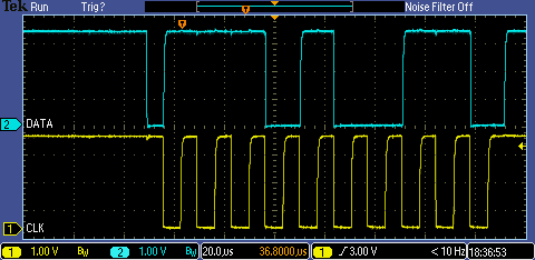

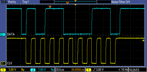

Part Number: TCA9535
Hi there
We just want to detect TI TCA9535RGER. However I2Cdetect -y -r found no such device
Please check if the following is correct or not.
PS. SCL, SDA, and INT# have pull up resistors on the other page.

Hi Mike,
I believe this device can dynamic address. Once VCC is powered up, the address is set. You may change the A2/A1/A0 pins between start and stop conditions before initiating a new I2C transaction.
Tyler
