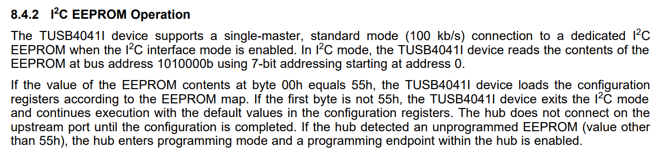

Does TUSB4041I has requirement for external EEPROM? Wether only the E2PROM start with 5Xh can be accessed? image.png

    There is no requirement for an external EEPROM. It is only needed if the default settings of the TUSB4041I need to be changed.
    If EEPROM is going to be used, address 00h of the EEPROM needs to be 55h, yes.

    If the USB HUB 4041I must use an external E2PROM, then the E2PROM address at that location needs to be 1010000b. May I ask if this address can be modified? In other words, can E2PROMs from other manufacturers with addresses other than 1010000b be accessed smoothly?
  • Hi Kailun,
    The EEPROM must be this address, yes. The TUSB4041I will only read from this address.
