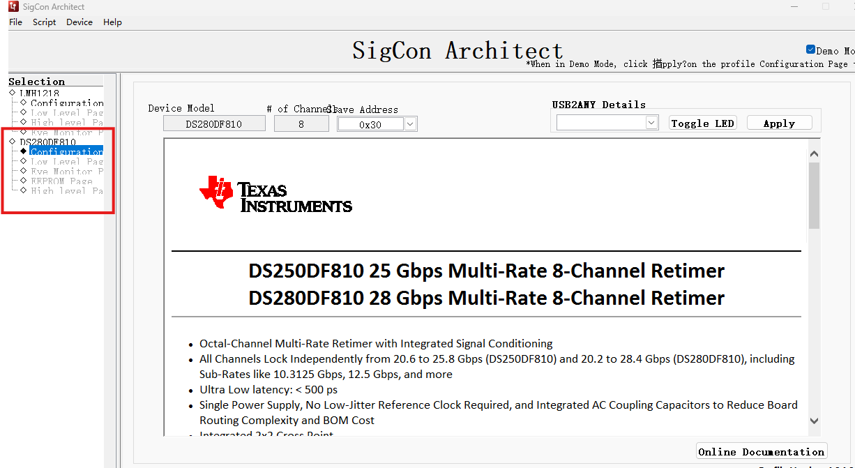

Hi Expert,
I'm using SigCon Architect to generate a EEPROM file in demo mode.
After install the DS280DF810 Updater profile, the left columns are not avaiable as below.

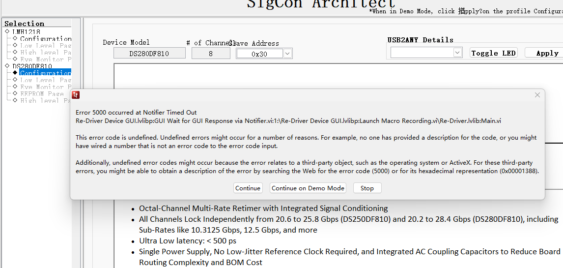

Also encountered below after Lanch Window.
Question 1: how to fix above issue?
Question 2: I'd like to re-gerenate the eeprom file from our prevous eeprom file, how to import one exsit file and generate a new file?
I appreciate your great support!
Zhao

  • Hi Zhao,
    I can check on the firmware. For the SigCon Demo Mode, are you seeing this error message after clicking the "Apply" button in the GUI? Also, could you please elaborate on generating the EEPROM file from the previous file? Are you trying to import a previous EEPROM hex file into SigCon Architect?
    Greg
  • Hi Greg,
    Thanks for your reply.
    I just took the task few weeks ago, so I have no idea how to generate the file.
    After click "Apply" button, i can find those pages.
    Also I generated a EEPROM file.
    Could you please check it? The configuration is supported 3 x 25Gbps, the whole EEPROM size is 32KB,
    If you need more details, please let me know.
