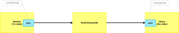

[Background]
They're performing ethernet communication via switching hub. Each master and slave equipment uses DP83867IR for PHY.
When transmitting data which exeeds max payload size of ethernet frame, the frame is divided. For this example, the frame is divided into 3 frames.

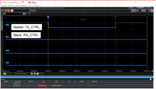

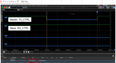

Sometime, the data frame transmitted from HUB excibits IFG, which is shorter than minimum required time(96ns). In this case, RX_CTRL signal of DP83867IR at Rx side toggles High/Low, indicating receive error. They repeat transmit data periodicaly(roughly several 10 ms) and the issue occurs about a few minutes later.
[Waveforms]
IFG of Tx side(above i and k) was about 96ns.
Above i: IFG of Tx side was about 96ns
Above k: IFG of Tx side was about 95.7ns

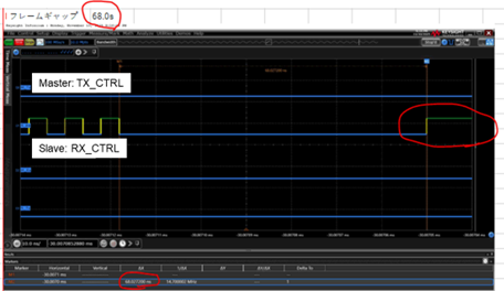

When the issue occurs, IFG(above j and l) was clearly less than 96ns.
Above j: IFG of Rx side was 79.9ns.
Above l: IFG of Rx side was 68.0ns.

    1.
    The waveforms of the RX_CTRL and RX_CLK signals are shown below.
    Also shown below is an enlarged image of the point where the IFG was shorter than 96 ns.
    Please note that bit[3:0] of the DP83867IR's RGMIIDCTL register (Address 0x0086) are set to "1000b," which means that RX_CLK has a delay time of 2.25 ns.
    Taking the RX_CLK delay into account, it appears that RX_CTRL changes to low on the falling edge of RX_CLK.
    Is this behavior when the IFG is shorter than the specified minimum value (96 ns)?
