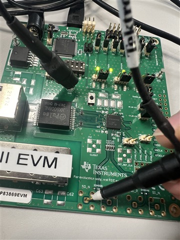

Hello, we are trying to connect to the DP83869EVM using ethernet and send SGMII out of the 4 SMA. We can see ethernet traffic going into the DP83869 chip using an oscilloscope from the ethernet cable, but it doesn’t come out of the chip and therefore no signal to the SMA. We have jumpers on OPMODE 1 and 2, none on OPMODE 0 nor MIRROR_EN. We populated C12, C14, C15, and C17 and removed R31, R38, R45, and R47. We have the SW modes normal operation (0000). What possible issues could there be causing the chip not to work?

    One thing I am curious on: Is the signal just a flat line at 0V when probing near C12 and C14, or is there a signal?
    • I was just seeing a flat line around 0V near those caps.

    Yes when we test on the chip side of C12 and C14 we see no signal whatsoever with differential probes. On the lines from the PC going into the DP83869 we can measure what is assumed auto negotiation(Figure 2-11 in snla443a). If you could test those output lines from the DP83869 in your lab to confirm what we should see that would be very helpful.

    I reworked my EVM for SGMII (populate C12/14/17/15, depop fiber resistors) and used the default jumper settings with OPMODE 2 and 1 jumpers populated. In this configuration I can see a signal on the SGMII outputs near the SMA:
    This is with nothing plugged into the RJ-45 side, so no data is transferring through the PHY. Even after writing the same registers you describe I still see the same signal coming from the SGMII outputs.
    Can you confirm our jumper settings are the same? If so, how are you probing the signal? I'm using a 10Mohm high-impedance single ended probe.
