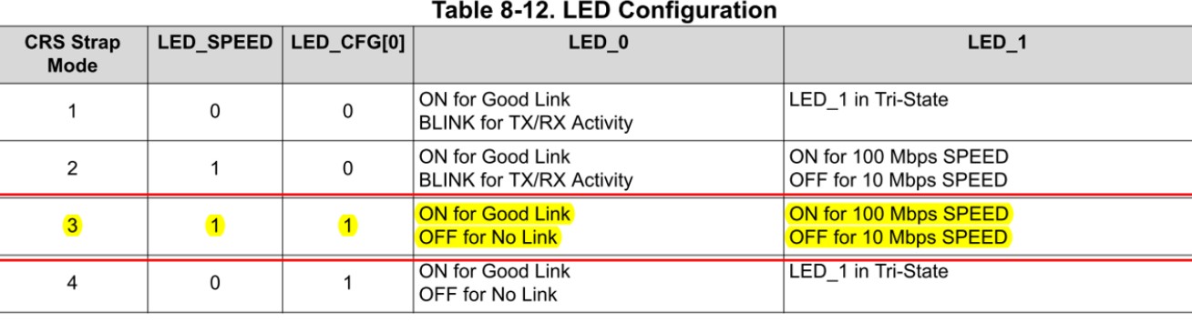

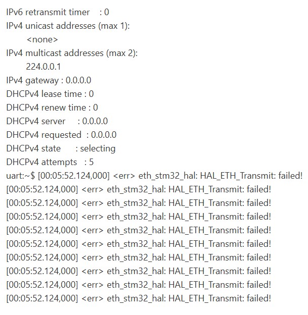

My customer got a problem with DP83822 that it can not get IP address from DHCP Server.
They observed that LED0 and LED1 are "turn ON" seems PHY link good and 100Mbps Okay.
Any suggestion how to debug this issue ?

  • Hi PY,
    DP838322 may have link, but that means that the PHY sees link on the MDI side. If the signal chain from the PHY to the MAC is broken, the customer will not be able to get an IP address.
    Have they tried doing a MII loopback from the MAC to the PHY so they can verify if the MII signal chain is working okay?
    They can do it by setting bit 14 of register 00h high.
    Please let me know.
    J
