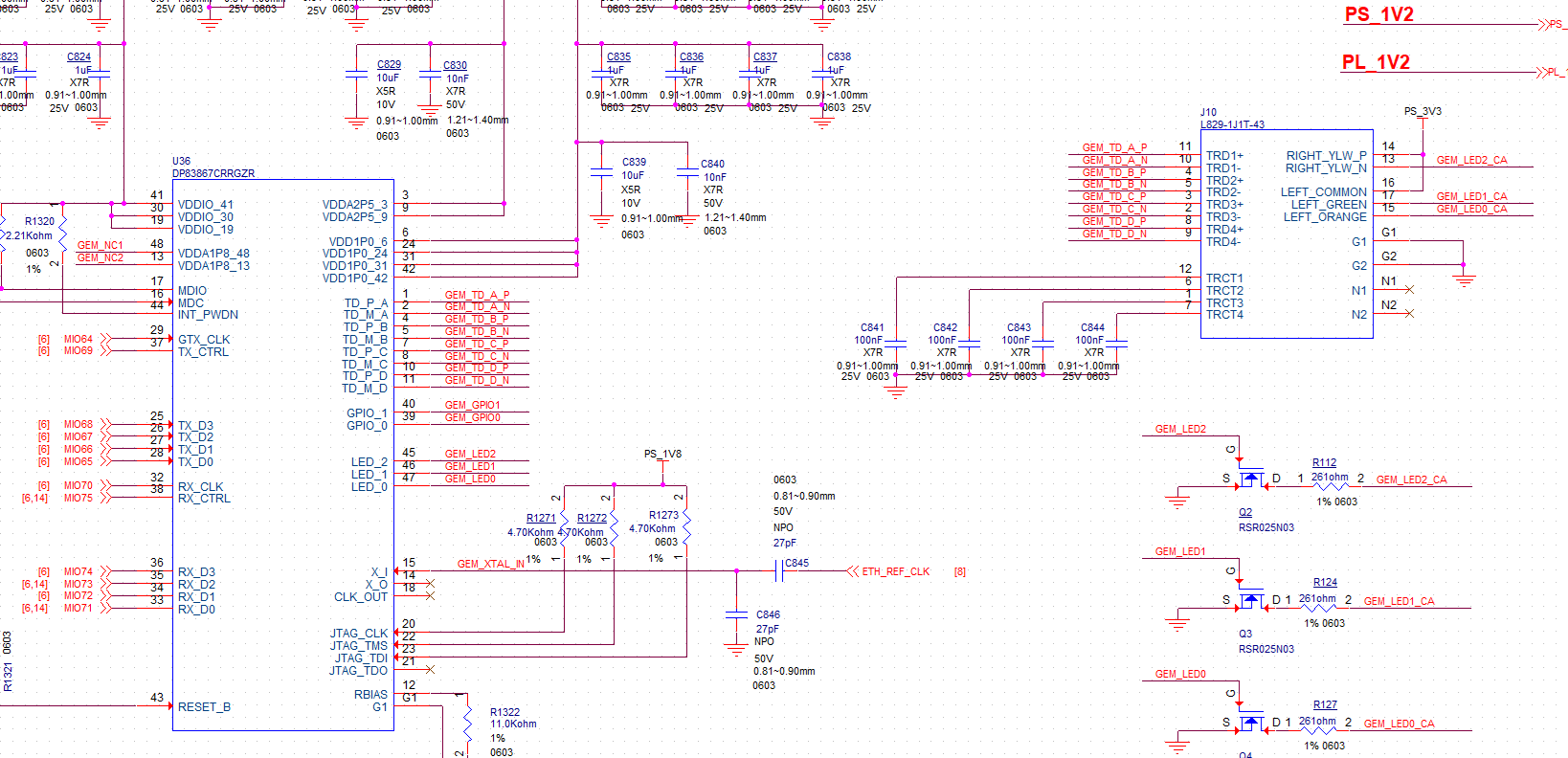

I would like to confirm if system side only provide the TRD 0/1 two lanes whether 83867 can identify and decode?
Roy

Hi Roy,
DP83867 can detect the correct two lanes through auto MDIX, however the speed would be limited to 10M/100M.
Is there a reason the customer uses a 1G PHY in a 10M/100M application? The schematic shows a 4-lane RJ-45 but I'm not sure how J119 and J110 are connecting to the PHY.
