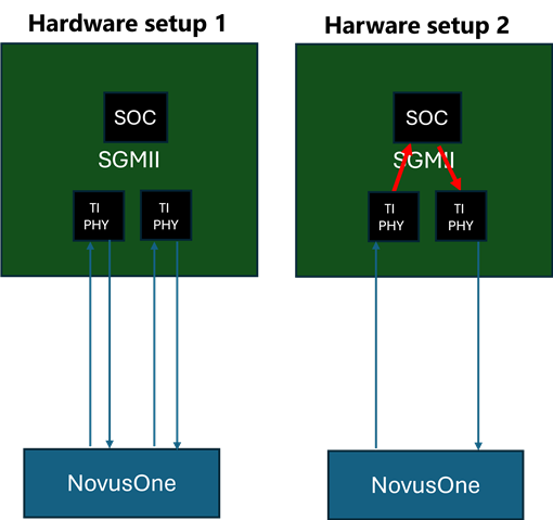

I would like to discuss with you about an issue found with TI DP83867 PHY embedded on our new boards. Let me explain test scenario and test HW setup:
Hardware setup 1:
  • The DUT is connected to Keysight NovusOne equipment
  • The TI PHY DP83867 is configured in “reverse loopback mode”
  • Cable length: 2.5m
Hardware setup 2:
  • The TI PHY DP83867 is configured in “normal operation mode”
Test scenario:
  • The NovusOne equipment sends packets to the DUT with the following settings:
    • IGP: 12
    • 100% line rate used
    • Packet fixed size to 512B
àResults:
  • Runing the test scenario above on the “hardware setup 1” we observe huge amount of CRC errors at the RX side of the NovusOne equipment
  • Runing the test scenario above on the “hardware setup 2” we observe huge amount of CRC errors at the RX side of the MAC (on the DUT) connected to the PHY
Note: we have two RJ45 ports, so 2 a TI dp83867 PHY and we get the same result on both ports.

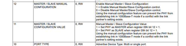

  • Hi Alex,
    This can be due to master/slave configuration of the link between the DUT and the LP.
    This is another factor that changes based on every link up. Bit 14 and 15 of register 0x000A will hold this value. Could this values be checked in the working and non-working condition?
    If this is the case, you can manually set master/slave using the bits below in register 0x0009:
    Please let me know.
    J
  • Hi
    I can see that sometimes these bits change but I cannot link it to my issues. For example, with values 0x3 for bit [15..14] I can get CRC errors and after link down/up with the same value, I don't get CRC errors.
    regards
    Alex
