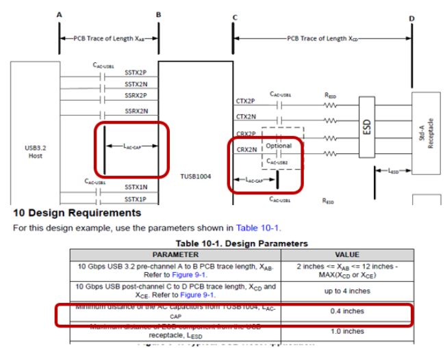

Hi AE,
      We noticed the datasheet requires a minimum 0.4-inch L_AC-Cap trace and no more than two vias.
      But our layout is limited to 111 mil with three vias.
      Any suggestions, or should we rely on test data for optimization?
