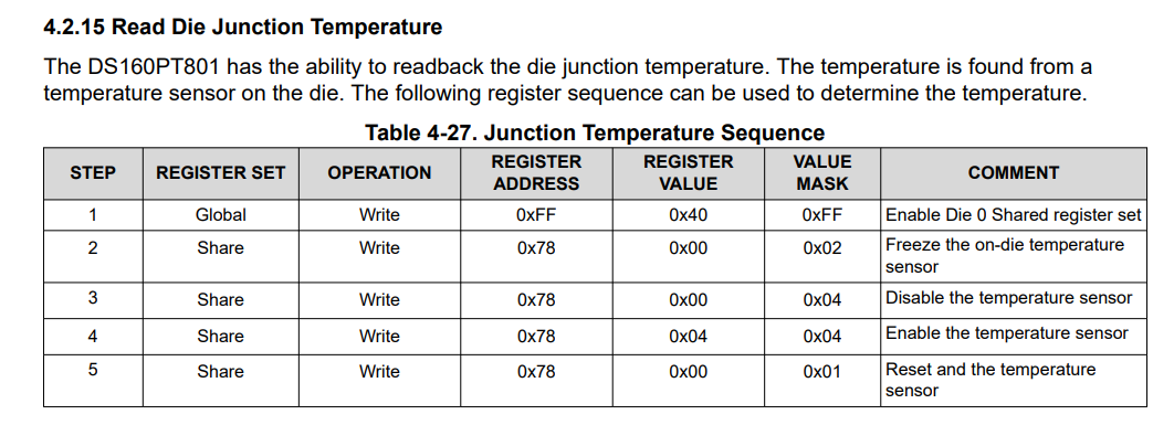

We are trying to read Read Die Junction Temperature  as 4.2.15
I want check how to set value mask.
Seems just need select the bit which I want to modify?
Or something else we need to do? Thanks!
