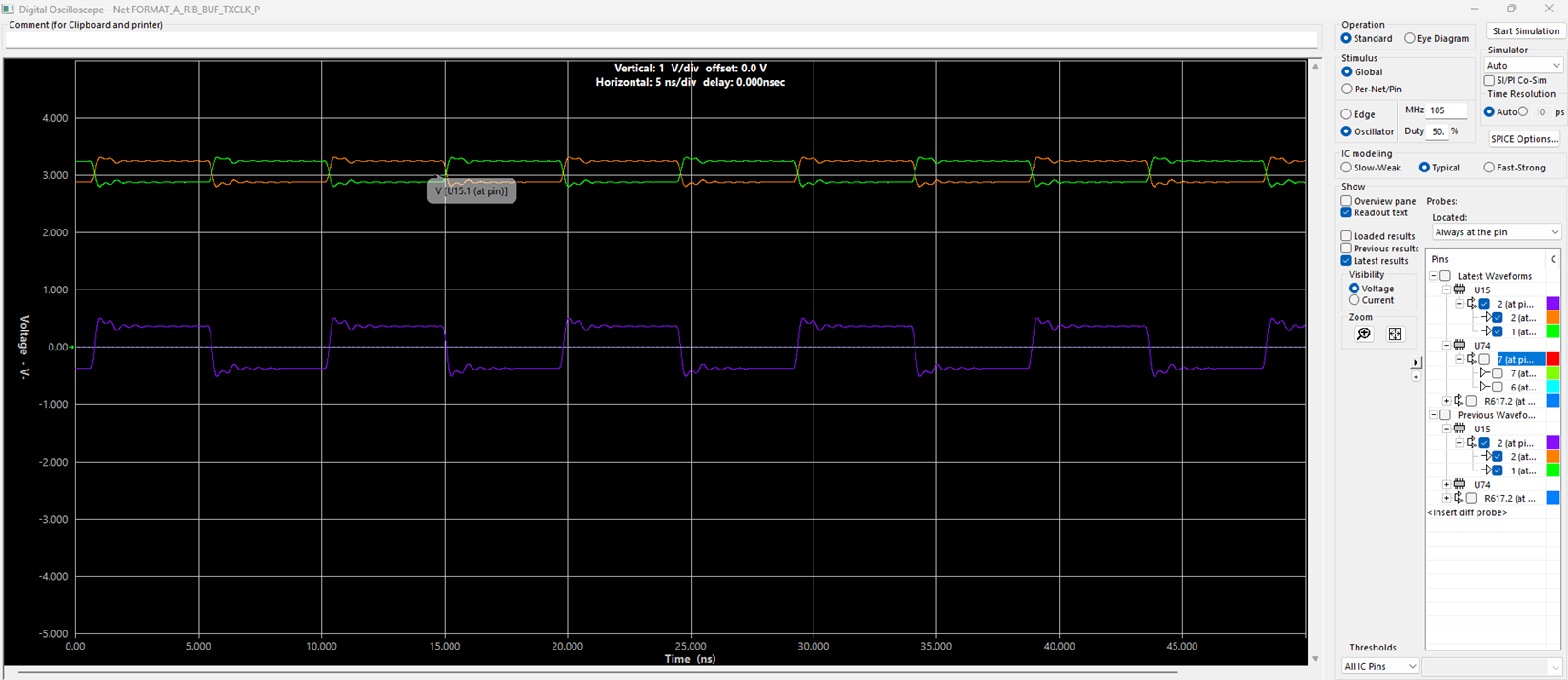

  I am running SI simulation for the output side i.e CML side.
 SN65CML100 connected with CML receiver with 50ohm pull-up to 3.3V.
 In the typical mode CML output looks fine, but when i am running at fast-strong could see more overshoot and undershoot attached waveform referance.(1st: Fast Strong and 2nd: Typical).
I tried simulate SN65CML100 without any receiver connected, at fast-strong mode, still i can see the issue.
Currently i am using IBIS model downloaded from TI website, Do we have any other IBIS model..?
