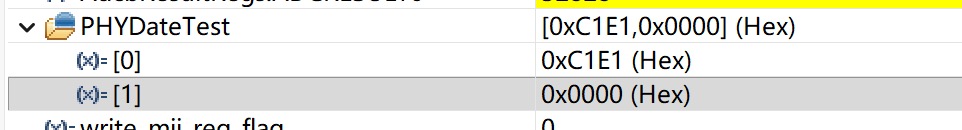

Below is the state and CRC info of DP83826 (Drive 2) and DP83822(Drive 1), it shows DP83822's state is stable, but DP83826's are changed.
We read the info of resistor 0x25 and C1E1 is be read, which seems not right.1119_1.png

  • Hi team, below is the test data from my customer, pls help on potential reasons.
    Customers attempted to configure the MLEDCR Register (Offset = 0x25) [Reset Value = 0x0041] to 0x0001
    via the F28P650SK7 MDIO interface, aiming to set LED0 to work in the LINK OK state.
    however, this operation failed.
    Customer performed the following read tests:
    Step 1:
    Read the BMSR Register (Offset = 0x01) [Reset Value = 0x7849]
    PHYDateTest[0] = read_mii_reg(0x01, 0x01);
    The read value was 0x7849, which matches the default reset value.
    Step 2:
    Read the MLEDCR Register (Offset = 0x25) [Reset Value = 0x0041]
    PHYDateTest[0] = read_mii_reg(0x01, 0x25);
    The read value was 0xC1E1, which is inconsistent with the default reset value.
    Based on the above results, the read function customer used appears to work normally (as verified by Step 1),but the 0x25 register behaves abnormally.

  • Hi Joyce,
    Is the customer using the correct method for extended register access?
    Register 0x25 is an extended register that cannot be directly read or written to. You need to use the correct method for accessing extended registers in order to see the right data.
