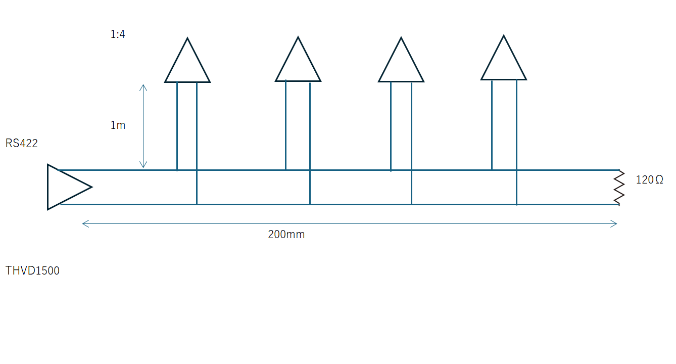

Do you think the following drawings is acceptable design for rs422 device usage?
  • Hi Hiroyasu,
    So in general your unterminated stubs should never be longer than your main bus - that is a general rule of thumb for any wired communication interface.
    That being said - you don't even need a termination because the bus length is so short - the longest pathway the signal may take is like 1.2m - which for the THVD1500 isn't even long enough to see reflections due to signal transitions.
    So in conclusion:
    1. Main trunk shouldn't be longer than unterminated stubs
    2. However - since your bus is so short - you don't even need the termination at all because reflections are not a concern with the size of your bus.
    So remove the termination (or don't - but it isn't really doing anything) and you would probably be good to go - the termination isn't going to help signal integrity with how short your bus is - it just is burning power.
