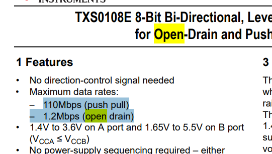

Hi Expert,
Can you help clarify why the device's maximum rate for Open drain applications is much lower than the rate for push pull applications?
Hailiang
Hi Jack,
The pull up will affect the data rate of open drain, right? So with a stronger pull up, the data rate will higher, why we define the max data rate as 1.2M?
Hailiang
Hello Hailiang,
We will take a look at your question and respond by Monday. Thanks!
Josh
Hi Hailiang,
You are correct, however it is not suggested to use external pullups with this device due to heightened VOL levels as a parallel network is formed with the internal 10kohm pullups.
If customer wants to achieve faster open-drain data rate, they can also refer to the LSF0108 here that requires external pullups (in which its max supported freq. is directly depended on the external RC load).
