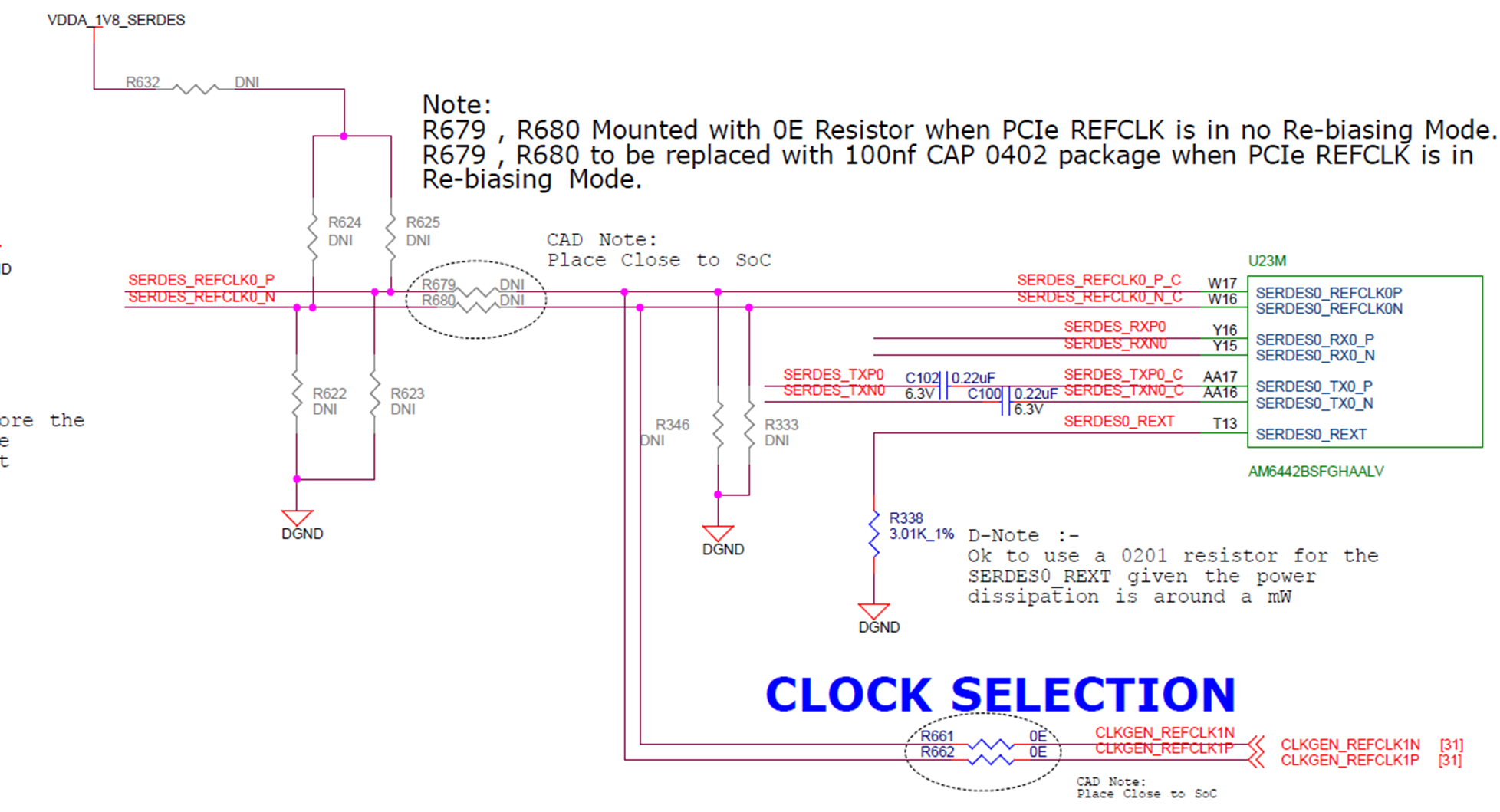

 DearTI engineer
AM64x/AM243x Evaluation Module  PCIe Interface
PCIe Interface circuit for AM64x/AM243x Evaluation Module
Use the internal processor clock as an output
The constants in this case are not listed in the circuit diagram.

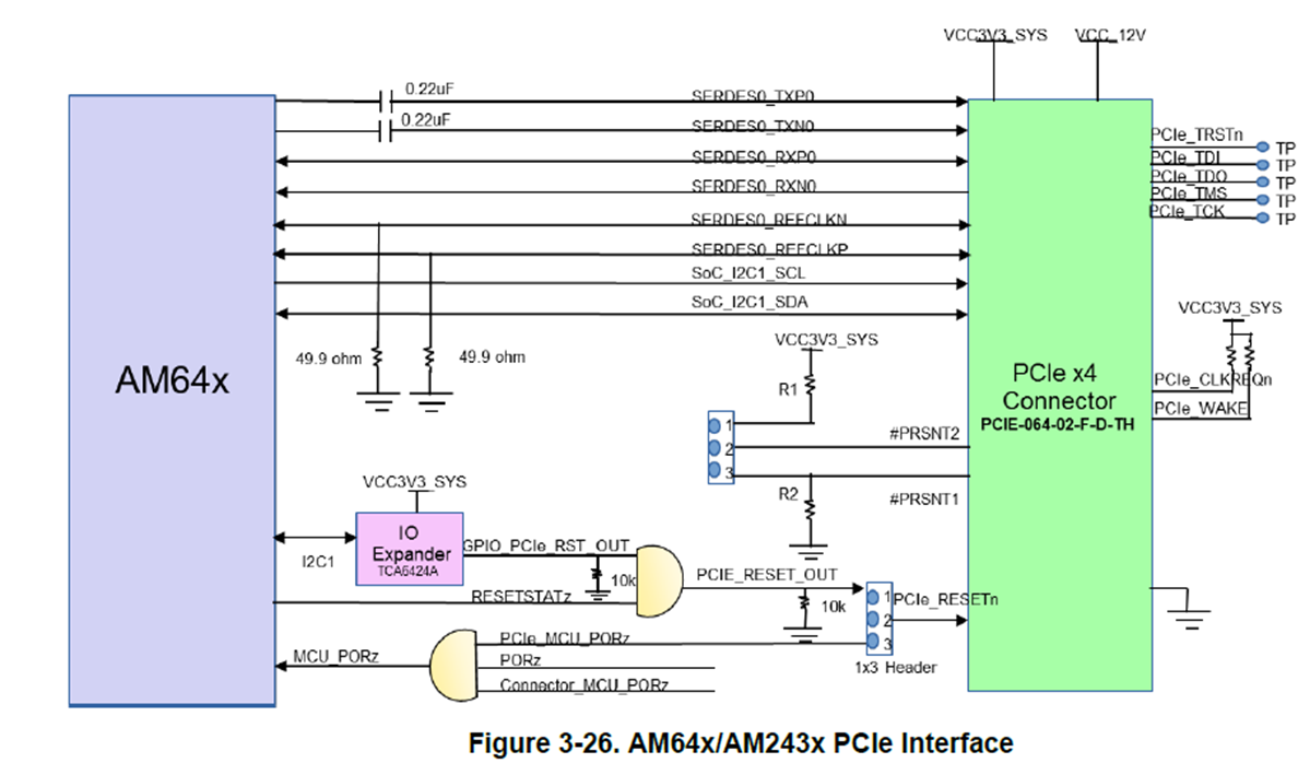

From the user guide
IFyou use internal processor clock as an output.
we recommend placing a 49.9Ohm resistor to GND close to the processor for both the CLKP/CLKN  signals.
R346 and R333 =49.9
R679 and R680 =0
R661 and R662 =NOT MOUNT
About  R632 and R624 and R625  and R622 and R623  is need ???
IF need.
What is value?
