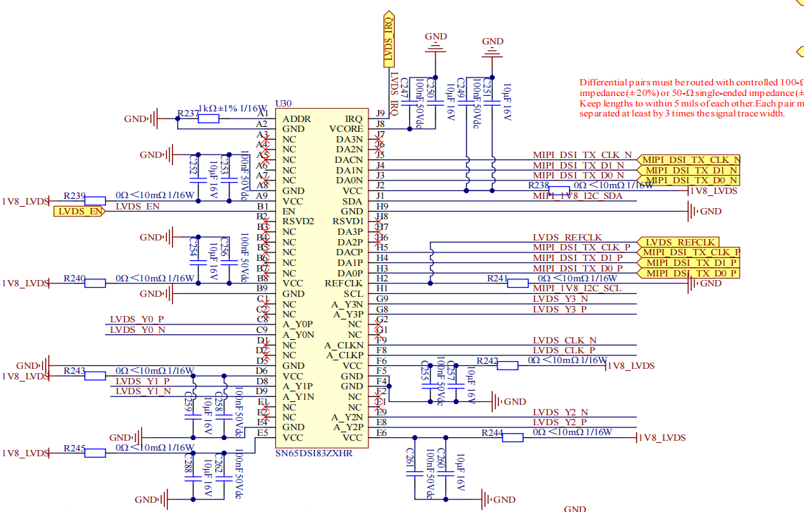

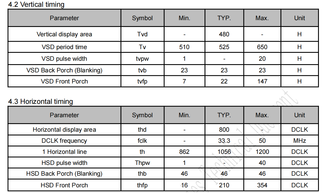

I am currently debugging MIPI to LVDS. First, I need to confirm whether the hardware is working properly. I can configure SN65DSI83 via I2C. I tried using the tunner tool to generate sequences, but the test pattern still doesn't display on the screen. It seems the clock is not aligned. I found a 24M clock that can be connected to the chip. May I ask how to configure the tunner? I have attached the schematic diagram and screen parameters.
Are there any precautions for controlling the enable pin of the chip?

    You can take a look at our schematic diagram. We have a 2-lane MIPI that converts to 4-lane LVDS.
    I have another question. Our MIPI has 2 lanes, and the target LVDS for conversion needs to have 4 lanes. Is that okay? ​
    I'm worried that a 2-lane MIPI can only convert to a 2-lane LVDS.
  • Hi Hailei,
    Yes this should be okay. The LVDS output will be 3 or 4 lane, depending on the bits per pixel (color depth). And the input vary in number of DSI lanes used.
    However, note that the device will have to be programmed based on number of DSI lanes used, and resulting DSI clock rate for that resolution.
    Please let us know if you have further questions, or any queries about using the DSI Tuner tool.

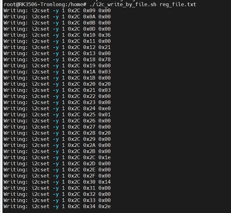

  • I used a 32M reference clock and generated some configurations through a tunner, which enabled the display of images. However, there are some noise points in the images. ​
    1. Where is the anomaly? Are there any guidelines? ​
    1. The data sheet seems to be inconsistent. The tool requires writing 0x36 to register 0x10, but bits 1 and 2 are not described in the data sheet.

  • Hi Hailei,
    These bits are ignored here since they are only used for channel B, which is not applicable here. This should be okay.
    Did you try using the test pattern? Please program with test pattern enabled and check if the timings are okay.
    It's possible that the REFCLK frequency and the DSI video data lanes do not match frequency exact causing this issue. What DSI clock frequency is the DSI source set to? Is it for precisely 32 MHz LVDS clock output as well?
    Ikram
