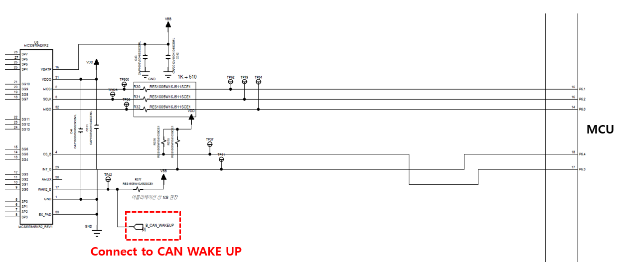

Using the TCAN1473-Q1, I configured the circuit as follows. Can you confirm that the circuit configuration is appropriate?

Hi HynGun,
The schematic looks good overall. I would recommend to ensure each supply pin includes individual decoupling capacitor as close as possible. You may also help promote ESD2CAN24-Q1 for CAN applications, thanks.
