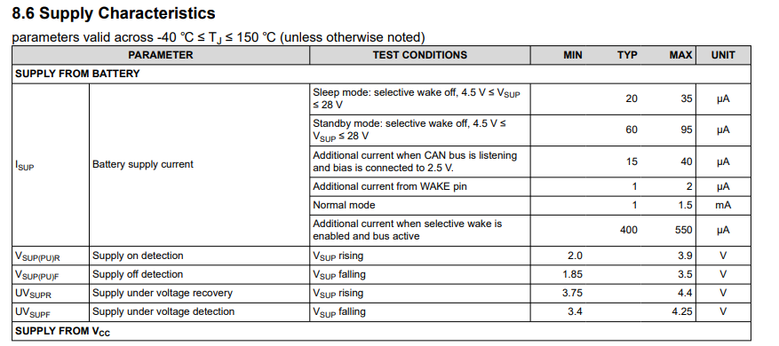

After initialization, once the TCAN1145-Q is powered only by VBAT, the chip should operate in Standby mode. Should the chip's leakage current be evaluated according to the standby mode diagram below?(Sector 8.6)
    Yes, the transceiver will enter Standby mode when only VSUP is applied at power up. ISUP, ICC, and IIO will all be drawing current depending on what supply is present (depending on VCC and VIO). ISUP is the primary supply though while in Standby mode. Note that at power up, the Sleep Wake Error (SWE) timer is active. This means that if TCAN1145 stays in Standby mode for more than 5 minutes, then it will transition to Sleep mode to conserve power on its own.

  • Hi Ethan:
    For the first question, when calculate the leakage current, whether the additional current when CAN bus is listening should be add, the 15uA, the condition is that the chip works in standby mode waiting for the valid wake-up request?

  • Hi Zephlyn,
    You can reference Figure 11-4 (Figure 11-3 can also be helpful) in the datasheet for how TCAN114x biases the CAN bus.
    Essentially, if the CAN bus is inactive, then bus biasing will be turned off and the additional 15uA can be disregarded. With a valid WUP (aka an active CAN bus), the bus will be biased to 2.5V while in Standby mode (meaning an extra 15uA is used). After time tSILENCE of ~1 second of bus inactivity, the bus will become unbiased.

  • Hi Ethan:
    That's helpful, thank you for your clear reply.
    The conclusion is if the chip works in sleep mode, the leakage current only calculate the type 20uA, right?
    And the test condition "Selective wake off", whether it means the funtion is enable, not be effective?

  • Hi Zephlyn,
    Apologies for my delayed response.
    Yes this is correct. Only 20uA should be considered for the leakage current while in Sleep mode. If Selective Wake is enabled and active (400uA), it will only be active for a short period of time.
    "Selective wake off" means that is not active at that moment, regardless whether it is enabled or not. TCAN1145 can be in Sleep mode with SW off (since it is not actively checking for a Valid ID), while SW is still enabled
