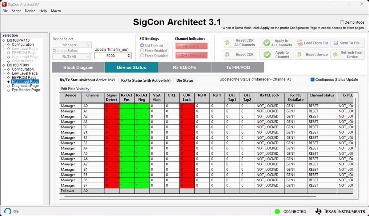

    "The DS160PT801_.x8_clkreq_refclkout.hex file you provided previously seems to have some issues:
    • On the EVM Board: After flashing the firmware, the graphics card fails to display, and the OS cannot detect the device. The measured voltage at Re-timer Pin B11 (CLKREQ) is 0V.
    • On the EFOCU8B Board: Similarly, there is no display and the device is not detected in the OS. However, the Re-timer Pin B11 (CLKREQ) measures 0.6V (it is expected to be 0V).
    Questions:
    1. Why is the CLKREQ voltage at 0.6V on the this design?
    2. Why does the system fail to display or detect the device after setting CLKREQ=LOW (Register 0xFA = 0x30)?
      The GUI indicates that the Channel status is in a 'RESET' state."
  • Hi Undrea,
    Any update for above questions? thanks!
    Jeff
  • Hi Jeff,
    We apologize for the delay. It seems like when DS160PT801_.x8_clkreq_refclkout.hex was initially shared, it worked as expected. Did anything in the EEPROM image or hardware setup change? Please also share the EEPROM image currently being used while this issue is seen.
    Greg
  • Hi Greg,
    The initial "Pass" result might have been inaccurate because the system may not have been power-cycled at that time. Note that I did not modify the values in the original DS160PT801_.x8_clkreq_refclkout.hex file. During the current testing process, a full power cycle was performed after every EEPROM programming.
    image.zip
    Test Observations
    • Case 1: EVM Board
      • Scenario: Programmed with the HEX file and connected to a GPU.
      • Result: No display; device not detected by the OS.
      • Measurement: After removing the J16 jumper, Pin B11 (CLKREQ#) measured 0V.
      • Note: Prior to programming the HEX file, this pin measured 0.6V.
    • Case 2: EFOCU8B Board
      • Measurement: Pin B11 (CLKREQ#) measured 0.6V (expected value is 0V).
      • Note: Pin B11 was in a floating state during this measurement.
    Modified HEX File Results
    The attached HEX file contains my modifications. The results are as follows:
    1. FW Code NOT set to CLKREQ# Low (0xFA = 0x30):
      • Actual Physical Measurement: Pin B11 is Low.
    2. FW Code SET to CLKREQ# Low (0xFA = 0x30):
      • Actual Physical Measurement: The GPU still fails to display.
    EFOCU8x_clk_x8_Pass.hex base on DS160PT801_1x16_Alt.hex
    PCIe x8
    0xF2=0x81, 0xF3=0xA0
    REFCLK OUT Enable
    0x0D=0x91
    Result
    The GPU displays normally, and Pin B11 (CLKREQ#) is measured at 0V while the pin is in a floating state.
    Note:Checking the GUI, Register 0xFA is read as 0x00.
    EFOCU8x_clk_x8_req_Fail.hex base on DS160PT801_1x16_Alt.hex
    PCIe x8
    REFCLK OUT Enable
    0x0D=0x91
    CLKREQ# low
    0xFA=0x30
    Result
    The GPU fails to display and the device is not detected by the OS. Physical measurement shows Pin B11 (CLKREQ#) is 0.6V while in a floating state.

  • Hi Jeff,
    In the second case, why is pin B11 (CLKREQ#) in a floating state during measurement? This could potentially be hardware related as opposed to EEPROM. To confirm, I wanted to validate the schematic of the design. It looks like you attached one in the original post, but it is password protected. Could you please share the latest schematic (or a password for the original one). You can send it over E2E private message if needed.
    Greg
  • Hi Greg,
    I've send the schematic via privacy message.
    Thanks!
    Jeff
  • Hi Greg,
    May I know there any update for this issue? thanks!
    Jeff
  • Hi Jeff,
    I am looking into this and will have comments by the end of the week. Thank you for your patience.
    Charles
  • Hi Charles,
    Please let us know if have any comments. thank you!
    Jeff
  • Hi Jeff,
    Please help me understand the current issue:
    You require DS160PT801 EEPROM that writes:
    1. Re-Timer Address: 0x28 (Single chip)
    2. PCIe Bandwidth: 1 x8 (Single chip)
    3. REFCLK OUT: Enabled
    4. CLKREQ#: Keep low at all times
    Using EFOCU8x_clk_x8_Pass.hex, it seems like we can address points 1, 2, 3. However with point 4, you see:
    What does it mean for CLKREQ# pin to measure 0V and be floating at the same time? What is the problem here? Since GPU displays normally, is EFOCU8x_clk_x8_Pass.hex EEPROM OK?
    Sorry for the delay on this. I will do my best to respond promptly.
    Charles
