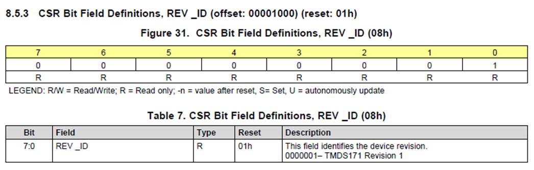

Hi All,
Please kindly tell me "Table 7. CSR Bit Field Definitions, REV _ID (08h)" in "8.5.3 CSR Bit Field Definitions, REV _ID (offset: 00001000) (reset: 01h)" contents.
I think that this 08h register should normally read 01h in Revision, but it reads 00h instead.
I'm sorry but, would you kindly tell me why 00h is being read out instead of 01h?
Hayashi

    Register 0x08 provides the revision ID of the TMDS171 DIE. If they read the register 0x00 to 0x07, are they able to read correctly the DEVICE_ID?

    Both DEVICE_ID and REV_ID are read only registers, I am trying to differentiate the issue between the I2C setup or device. If DEVICE_ID is able to read correctly, then the I2C setup is ok and they may have an older TMDS171 unit.
