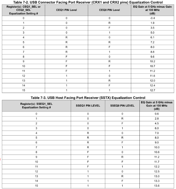

Hi AE,
      The current Pre-Channel total and Post-Channel total are as follows.
      Could you help recommend the appropriate settings for CEQ1, CEQ0 and SSEQ1, SSEQ0?
project
CEQ1
CEQ0
SSEQ1
SSEQ0
Pre-Channel total
Post-Channel total
TUSB1142
F
F
1
F
2678 mils
1387 mils
