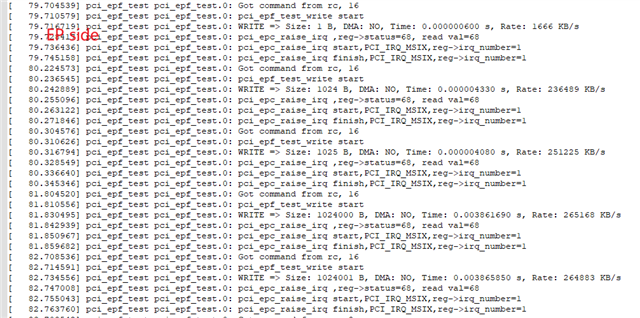

    During debugging of data read and write, it was found that in pci_endpoint_test.c, in the function static irqreturn_t pci_endpoint_test_irqhandler(int irq, void *dev_id), the register value reg read from PCI_ENDPOINT_TEST_STATUS was 0, which caused the code to not reach complete(&test->irq_raised); Furthermore, during testing, the read and write successes happen randomly, but most of the time failures occur.
    Please help explain what causes the PCI_ENDPOINT_TEST_STATUS register to read a value of 0 during the data read/write process, and who sets it? RC or EP?

  • Hi Quansheng,
    Below is a description of PCI_ENDPOINT_TEST_STATUS.
    * PCI_ENDPOINT_TEST_STATUS
    This register reflects the status of the PCI endpoint device.
    Bitfield	Description
    Bit 0		read success
    Bit 1		read fail
    Bit 2		write success
    Bit 3		write fail
    Bit 4		copy success
    Bit 5		copy fail
    Bit 6		IRQ raised
    Bit 7		source address is invalid
    Bit 8		destination address is invalid
    The PCI_ENDPOINT_TEST_STATUS bits are set within the pci-epf-test.c driver that will run on the EP-side. The pcitest binary that is used by the bash script should send out a command to pci-epf-test by writing to the PCI_ENDPOINT_TEST_COMMAND register. On EP-side, they are then handled by the cmd_handler to call various functions depending on the command.
    For troubleshooting, you could put some print statements below to see if the cmd_handler is getting called properly:
    https://git.ti.com/cgit/ti-linux-kernel/ti-linux-kernel/tree/drivers/pci/endpoint/functions/pci-epf-test.c?h=ti-linux-6.1.y#n643
    Takuma

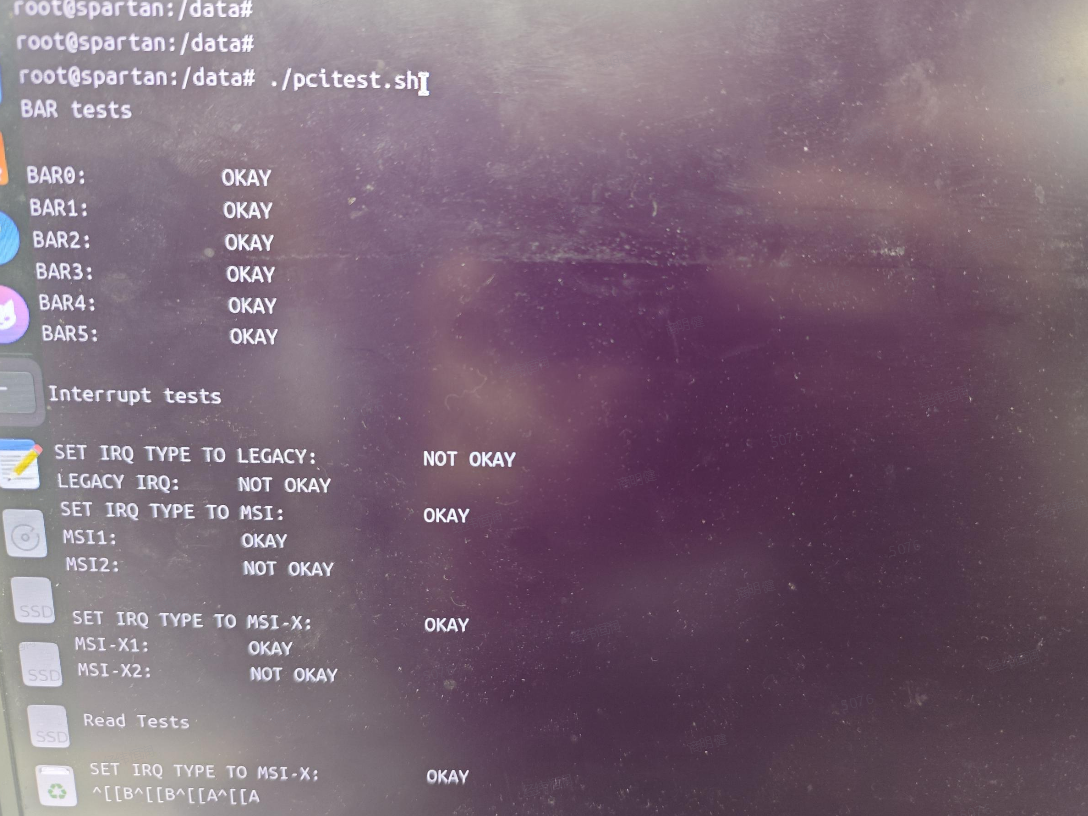

  • Hi Takuma,
    We added the print in pci-epf-test.c and pci-endpoint-test.c. Seems like EP did not got the correct command when RC write it corrrectly.
    RC log:
    root@spartan_a:/data# ./pcitest.sh
    BAR tests
    BAR0:           OKAY
    BAR1:           OKAY
    BAR2:           OKAY
    BAR3:           OKAY
    BAR4:           OKAY
    BAR5:           OKAY
    Interrupt tests
    SET IRQ TYPE TO LEGACY:         NOT OKAY
    LEGACY IRQ:     NOT OKAY
    SET IRQ TYPE TO MSI:            OKAY
    MSI1:           OKAY
    MSI2:           NOT OKAY
    SET IRQ TYPE TO MSI-X:          OKAY
    MSI-X1:         NOT OKAY
    MSI-X2:         OKAY
    Read Tests
    READ (      1 bytes):           OKAY
    READ (   1024 bytes):           OKAY
    READ (   1025 bytes):           OKAY
    READ (1024000 bytes):           OKAY
    READ (1024001 bytes):           OKAY
    Write Tests
    WRITE (      1 bytes):          OKAY
    WRITE (   1024 bytes):          OKAY
    WRITE (   1025 bytes):          OKAY
    WRITE (1024000 bytes):          NOT OKAY
    WRITE (1024001 bytes):          OKAY
    Copy Tests
    COPY (      1 bytes):           OKAY
    COPY (   1024 bytes):           OKAY
    COPY (   1025 bytes):           OKAY
    COPY (1024000 bytes):           OKAY
    COPY (1024001 bytes):           OKAY

    [    2.689984] pcieport 0000:00:00.0: of_irq_parse_pci: failed with rc=-22
    [    2.696938] pcieport 0000:00:00.0: PME: Signaling with IRQ 513
    [    2.703064] pcieport 0000:00:00.0: AER: enabled with IRQ 513
    [   69.733641] pci 0000:01:00.0: [104c:b010] type 00 class 0xff0000 PCIe Endpoint
    [   69.740926] pci 0000:01:00.0: BAR 0 [mem 0x00000000-0x000000ff]
    [   69.746881] pci 0000:01:00.0: BAR 1 [mem 0x00000000-0x000001ff]
    [   69.752833] pci 0000:01:00.0: BAR 2 [mem 0x00000000-0x000003ff]
    [   69.758773] pci 0000:01:00.0: BAR 3 [mem 0x00000000-0x00003fff]
    [   69.764724] pci 0000:01:00.0: BAR 4 [mem 0x00000000-0x0001ffff]
    [   69.770662] pci 0000:01:00.0: BAR 5 [mem 0x00000000-0x000fffff]
    [   69.776874] pci 0000:01:00.0: supports D1
    [   69.780893] pci 0000:01:00.0: PME# supported from D0 D1 D3hot
    [   69.792910] pcieport 0000:00:00.0: bridge window [mem 0x600200000-0x6003fffff]: assigned
    [   69.801061] pci 0000:01:00.0: BAR 5 [mem 0x600200000-0x6002fffff]: assigned
    [   69.808061] pci 0000:01:00.0: BAR 4 [mem 0x600300000-0x60031ffff]: assigned
    [   69.815061] pci 0000:01:00.0: BAR 3 [mem 0x600320000-0x600323fff]: assigned
    [   69.822038] pci 0000:01:00.0: BAR 2 [mem 0x600324000-0x6003243ff]: assigned
    [   69.829025] pci 0000:01:00.0: BAR 1 [mem 0x600324400-0x6003245ff]: assigned
    [   69.835999] pci 0000:01:00.0: BAR 0 [mem 0x600324600-0x6003246ff]: assigned
    [   69.843200] pcieport 0000:00:00.0: of_irq_parse_pci: failed with rc=-22
    [   69.849850] pci-endpoint-test 0000:01:00.0: enabling device (0000 -> 0002)
    [   86.880954] pci-endpoint-test 0000:01:00.0: Failed to get Legacy interrupt
    [   87.920157] pci-endpoint-test 0000:01:00.0: pci_endpoint_test_msi_irq, write command 2
    [   88.692639] pci-endpoint-test 0000:01:00.0: pci_endpoint_test_msi_irq, write command 2
    [   89.717115] pci-endpoint-test 0000:01:00.0: pci_endpoint_test_msi_irq, write command 4
    [   90.736461] pci-endpoint-test 0000:01:00.0: pci_endpoint_test_msi_irq, write command 4
    [   90.782716] pci-endpoint-test 0000:01:00.0: pci_endpoint_test_read start
    [   90.789479] pci-endpoint-test 0000:01:00.0: pci_endpoint_test_read, write command 16
    [   91.044624] pci-endpoint-test 0000:01:00.0: pci_endpoint_test_read start
    [   91.051383] pci-endpoint-test 0000:01:00.0: pci_endpoint_test_read, write command 16
    [   92.076298] pci-endpoint-test 0000:01:00.0: pci_endpoint_test_read start
    [   92.083080] pci-endpoint-test 0000:01:00.0: pci_endpoint_test_read, write command 16
    [   93.100352] pci-endpoint-test 0000:01:00.0: pci_endpoint_test_read start
    [   93.107526] pci-endpoint-test 0000:01:00.0: pci_endpoint_test_read, write command 16
    [   94.124990] pci-endpoint-test 0000:01:00.0: pci_endpoint_test_read start
    [   94.131958] pci-endpoint-test 0000:01:00.0: pci_endpoint_test_read, write command 16
    [   95.149366] pci-endpoint-test 0000:01:00.0: pci_endpoint_test_write start
    [   95.156210] pci-endpoint-test 0000:01:00.0: pci_endpoint_test_write, write command 8
    [   95.292205] pci-endpoint-test 0000:01:00.0: pci_endpoint_test_write start
    [   95.299076] pci-endpoint-test 0000:01:00.0: pci_endpoint_test_write, write command 8
    [   96.332272] pci-endpoint-test 0000:01:00.0: pci_endpoint_test_write start
    [   96.339133] pci-endpoint-test 0000:01:00.0: pci_endpoint_test_write, write command 8
    [   97.356281] pci-endpoint-test 0000:01:00.0: pci_endpoint_test_write start
    [   97.373150] pci-endpoint-test 0000:01:00.0: pci_endpoint_test_write, write command 8
    [   98.412336] pci-endpoint-test 0000:01:00.0: pci_endpoint_test_write start
    [   98.429151] pci-endpoint-test 0000:01:00.0: pci_endpoint_test_write, write command 8
    [   99.468610] pci-endpoint-test 0000:01:00.0: pci_endpoint_test_copy start
    [   99.475382] pci-endpoint-test 0000:01:00.0: pci_endpoint_test_copy, write command 32
    [  100.492278] pci-endpoint-test 0000:01:00.0: pci_endpoint_test_copy start
    [  100.499097] pci-endpoint-test 0000:01:00.0: pci_endpoint_test_copy, write command 32
    [  100.716687] pci-endpoint-test 0000:01:00.0: pci_endpoint_test_copy start
    [  100.723464] pci-endpoint-test 0000:01:00.0: pci_endpoint_test_copy, write command 32
    [  101.740221] pci-endpoint-test 0000:01:00.0: pci_endpoint_test_copy start
    [  101.757169] pci-endpoint-test 0000:01:00.0: pci_endpoint_test_copy, write command 32
    [  102.797068] pci-endpoint-test 0000:01:00.0: pci_endpoint_test_copy start
    [  102.814387] pci-endpoint-test 0000:01:00.0: pci_endpoint_test_copy, write command 32
    EP log:
    ▒[   87.636515] pci_epf_test pci_epf_test.0: Got command from rc, 1
    [   87.642474] pci_epf_test pci_epf_test.0: pci_epc_raise_irq start,PCI_IRQ_INTX,reg->irq_number=0
    [   87.652190] pci_epf_test pci_epf_test.0: pci_epc_raise_irq finish,PCI_IRQ_INTX,reg->irq_number=0
    [   88.632535] pci_epf_test pci_epf_test.0: Got command from rc, 2
    [   88.638489] pci_epf_test pci_epf_test.0: pci_epc_raise_irq start,PCI_IRQ_MSI,reg->irq_number=1
    [   88.647104] pci_epf_test pci_epf_test.0: pci_epc_raise_irq finish,PCI_IRQ_MSI,reg->irq_number=1
    [   90.712558] pci_epf_test pci_epf_test.0: Got command from rc, 4
    [   90.724540] pci_epf_test pci_epf_test.0: pci_epc_raise_irq start,PCI_IRQ_MSIX,reg->irq_number=2
    [   90.733362] pci_epf_test pci_epf_test.0: pci_epc_raise_irq finish,PCI_IRQ_MSIX,reg->irq_number=2
    [   90.964564] pci_epf_test pci_epf_test.0: Got command from rc, 16
    [   90.976536] pci_epf_test pci_epf_test.0: pci_epf_test_write start
    [   90.982727] pci_epf_test pci_epf_test.0: WRITE => Size: 1 B, DMA: NO, Time: 0.000000660 s, Rate: 1515 KB/s
    [   90.994523] pci_epf_test pci_epf_test.0: pci_epc_raise_irq start,PCI_IRQ_MSIX,reg->irq_number=1
    [   91.003303] pci_epf_test pci_epf_test.0: pci_epc_raise_irq finish,PCI_IRQ_MSIX,reg->irq_number=1
    [   91.016581] pci_epf_test pci_epf_test.0: Got command from rc, 16
    [   91.022671] pci_epf_test pci_epf_test.0: pci_epf_test_write start
    [   91.028848] pci_epf_test pci_epf_test.0: WRITE => Size: 1024 B, DMA: NO, Time: 0.000004090 s, Rate: 250366 KB/s
    [   91.040515] pci_epf_test pci_epf_test.0: pci_epc_raise_irq start,PCI_IRQ_MSIX,reg->irq_number=1
    [   91.049285] pci_epf_test pci_epf_test.0: pci_epc_raise_irq finish,PCI_IRQ_MSIX,reg->irq_number=1
    [   92.200514] pci_epf_test pci_epf_test.0: Got command from rc, 16
    [   92.206552] pci_epf_test pci_epf_test.0: pci_epf_test_write start
    [   92.212707] pci_epf_test pci_epf_test.0: WRITE => Size: 1025 B, DMA: NO, Time: 0.000004630 s, Rate: 221382 KB/s
    [   92.224519] pci_epf_test pci_epf_test.0: pci_epc_raise_irq start,PCI_IRQ_MSIX,reg->irq_number=1
    [   92.233229] pci_epf_test pci_epf_test.0: pci_epc_raise_irq finish,PCI_IRQ_MSIX,reg->irq_number=1
    [   93.196553] pci_epf_test pci_epf_test.0: Got command from rc, 16
    [   93.202610] pci_epf_test pci_epf_test.0: pci_epf_test_write start
    [   93.222555] pci_epf_test pci_epf_test.0: WRITE => Size: 1024000 B, DMA: NO, Time: 0.003841720 s, Rate: 266547 KB/s
    [   93.235008] pci_epf_test pci_epf_test.0: pci_epc_raise_irq start,PCI_IRQ_MSIX,reg->irq_number=1
    [   93.243725] pci_epf_test pci_epf_test.0: pci_epc_raise_irq finish,PCI_IRQ_MSIX,reg->irq_number=1
    [   94.204606] pci_epf_test pci_epf_test.0: Got command from rc, 16
    [   94.211792] pci_epf_test pci_epf_test.0: pci_epf_test_write start
    [   94.231867] pci_epf_test pci_epf_test.0: WRITE => Size: 1024001 B, DMA: NO, Time: 0.003861930 s, Rate: 265152 KB/s
    [   94.244342] pci_epf_test pci_epf_test.0: pci_epc_raise_irq start,PCI_IRQ_MSIX,reg->irq_number=1
    [   94.253058] pci_epf_test pci_epf_test.0: pci_epc_raise_irq finish,PCI_IRQ_MSIX,reg->irq_number=1
    [   95.220538] pci_epf_test pci_epf_test.0: Got command from rc, 8
    [   95.226485] pci_epf_test pci_epf_test.0: pci_epf_test_read start
    [   95.232618] pci_epf_test pci_epf_test.0: READ => Size: 1 B, DMA: NO, Time: 0.000001905 s, Rate: 524 KB/s
    [   95.242139] pci_epf_test pci_epf_test.0: pci_epc_raise_irq start,PCI_IRQ_MSIX,reg->irq_number=1
    [   95.250858] pci_epf_test pci_epf_test.0: pci_epc_raise_irq finish,PCI_IRQ_MSIX,reg->irq_number=1
    [   95.264521] pci_epf_test pci_epf_test.0: Got command from rc, 8
    [   95.270456] pci_epf_test pci_epf_test.0: pci_epf_test_read start
    [   95.276645] pci_epf_test pci_epf_test.0: READ => Size: 1024 B, DMA: NO, Time: 0.000145010 s, Rate: 7061 KB/s
    [   95.286525] pci_epf_test pci_epf_test.0: pci_epc_raise_irq start,PCI_IRQ_MSIX,reg->irq_number=1
    [   95.295238] pci_epf_test pci_epf_test.0: pci_epc_raise_irq finish,PCI_IRQ_MSIX,reg->irq_number=1
    [   96.540514] pci_epf_test pci_epf_test.0: Got command from rc, 8
    [   96.546469] pci_epf_test pci_epf_test.0: pci_epf_test_read start
    [   96.552674] pci_epf_test pci_epf_test.0: READ => Size: 1025 B, DMA: NO, Time: 0.000144630 s, Rate: 7087 KB/s
    [   96.562547] pci_epf_test pci_epf_test.0: pci_epc_raise_irq start,PCI_IRQ_MSIX,reg->irq_number=1
    [   96.571265] pci_epf_test pci_epf_test.0: pci_epc_raise_irq finish,PCI_IRQ_MSIX,reg->irq_number=1
    [   97.644547] pci_epf_test pci_epf_test.0: Got command from rc, 8
    [   97.650505] pci_epf_test pci_epf_test.0: pci_epf_test_read start
    [   97.801418] pci_epf_test pci_epf_test.0: READ => Size: 1024000 B, DMA: NO, Time: 0.144655190 s, Rate: 7078 KB/s
    [   97.812080] pci_epf_test pci_epf_test.0: pci_epc_raise_irq start,PCI_IRQ_MSIX,reg->irq_number=1
    [   97.820841] pci_epf_test pci_epf_test.0: pci_epc_raise_irq finish,PCI_IRQ_MSIX,reg->irq_number=1
    [   99.640543] pci_epf_test pci_epf_test.0: Got command from rc, 32
    [   99.646597] pci_epf_test pci_epf_test.0: pci_epf_test_copy start
    [   99.652677] pci_epf_test pci_epf_test.0: COPY => Size: 1 B, DMA: NO, Time: 0.000004005 s, Rate: 249 KB/s
    [   99.662186] pci_epf_test pci_epf_test.0: pci_epc_raise_irq start,PCI_IRQ_MSIX,reg->irq_number=1
    [   99.670898] pci_epf_test pci_epf_test.0: pci_epc_raise_irq finish,PCI_IRQ_MSIX,reg->irq_number=1
    [  100.644563] pci_epf_test pci_epf_test.0: Got command from rc, 32
    [  100.650602] pci_epf_test pci_epf_test.0: pci_epf_test_copy start
    [  100.656812] pci_epf_test pci_epf_test.0: COPY => Size: 1024 B, DMA: NO, Time: 0.000150290 s, Rate: 6813 KB/s
    [  100.666684] pci_epf_test pci_epf_test.0: pci_epc_raise_irq start,PCI_IRQ_MSIX,reg->irq_number=1
    [  100.675393] pci_epf_test pci_epf_test.0: pci_epc_raise_irq finish,PCI_IRQ_MSIX,reg->irq_number=1
    [  100.688517] pci_epf_test pci_epf_test.0: Got command from rc, 32
    [  100.694553] pci_epf_test pci_epf_test.0: pci_epf_test_copy start
    [  100.700755] pci_epf_test pci_epf_test.0: COPY => Size: 1025 B, DMA: NO, Time: 0.000152195 s, Rate: 6734 KB/s
    [  100.710634] pci_epf_test pci_epf_test.0: pci_epc_raise_irq start,PCI_IRQ_MSIX,reg->irq_number=1
    [  100.719350] pci_epf_test pci_epf_test.0: pci_epc_raise_irq finish,PCI_IRQ_MSIX,reg->irq_number=1
    [  101.792555] pci_epf_test pci_epf_test.0: Got command from rc, 32
    [  101.798638] pci_epf_test pci_epf_test.0: pci_epf_test_copy start
    [  101.953629] pci_epf_test pci_epf_test.0: COPY => Size: 1024000 B, DMA: NO, Time: 0.148787975 s, Rate: 6882 KB/s
    [  101.963795] pci_epf_test pci_epf_test.0: pci_epc_raise_irq start,PCI_IRQ_MSIX,reg->irq_number=1
    [  101.972519] pci_epf_test pci_epf_test.0: pci_epc_raise_irq finish,PCI_IRQ_MSIX,reg->irq_number=1
    [  103.264516] pci_epf_test pci_epf_test.0: Got command from rc, 32
    [  103.270552] pci_epf_test pci_epf_test.0: pci_epf_test_copy start
    [  103.425337] pci_epf_test pci_epf_test.0: COPY => Size: 1024001 B, DMA: NO, Time: 0.148673655 s, Rate: 6887 KB/s
    [  103.435495] pci_epf_test pci_epf_test.0: pci_epc_raise_irq start,PCI_IRQ_MSIX,reg->irq_number=1
    [  103.444210] pci_epf_test pci_epf_test.0: pci_epc_raise_irq finish,PCI_IRQ_MSIX,reg->irq_number=1
    The command printed from RC is using pci_endpoint_test_readl() after pci_endpoint_test_writel(). The read results are all correct. But sometimes EP could not get command from RC and did not enter the pci_endpoint_test_read() function. It caused the fail of RC's write test. The same issue happend in irq tests. RC should send  irq commands for 4 times but EP only received twice. Please help analyse the issue.
    Mingjian

  • Hi Takuma ,
    I tried using MSI-X instead of MSI, but seems that there is no difference.
    On the other side , I think I found the root cause of read, write and copy test fail. When RC pci_endpoint_test driver wrote pci bar space , such as COMMAND, it sometimes took 0.5 second or longer then EP can read the COMMAND which RC wrote and go to deal with the COMMAND. Such delay also exists when EP wrote, RC read. So when EP finish the COMMAND function(read,write,copy), EP wrote SUCCESS to the status bit and raise irq to inform RC. But when RC receive irq, RC  could not  read the status bit as SUCCESS, so it return fail.
    To validate the issue above, I disabled the irq callback  and add  3s delay after RC send COMMAND to EP.  After this modification, the read,write and copy test all success.
    Based on the above tests, I think this is a cache consistency issue. Could you provide some infomation about that? We didn't meet such issue on SDK0805, 0902 and 1001 before.

  • Hi Takuma,
    In fact, we have already done a read back on the EP side before irq raised.
    When EP side's prints are always right, RC sometime got the wrong STATUS value. So I think it's  a cache coherency issue.
    Mingjian

    >>Could you share the lspci -vvv logs from the RC-side?
    root@spartan_a:/# lspci
    00:00.0 PCI bridge: Texas Instruments Device b010
    01:00.0 Unassigned class [ff00]: Texas Instruments Device b010
    root@spartan_a:/# lspci -vvv
    00:00.0 PCI bridge: Texas Instruments Device b010 (prog-if 00 [Normal decode])
            Control: I/O- Mem- BusMaster+ SpecCycle- MemWINV- VGASnoop- ParErr- Stepping- SERR- FastB2B- DisINTx+
            Status: Cap+ 66MHz- UDF- FastB2B- ParErr- DEVSEL=fast >TAbort- <TAbort- <MAbort- >SERR- <PERR- INTx-
            Latency: 0
            Interrupt: pin A routed to IRQ 513
            Bus: primary=00, secondary=01, subordinate=01, sec-latency=0
            I/O behind bridge: 0000f000-00000fff [disabled] [32-bit]
            Memory behind bridge: 00200000-003fffff [size=2M] [32-bit]
            Prefetchable memory behind bridge: 00000000fff00000-00000000000fffff [disabled] [64-bit]
            Secondary status: 66MHz- FastB2B- ParErr- DEVSEL=fast >TAbort- <TAbort- <MAbort- <SERR- <PERR-
            BridgeCtl: Parity- SERR+ NoISA- VGA- VGA16- MAbort- >Reset- FastB2B-
                    PriDiscTmr- SecDiscTmr- DiscTmrStat- DiscTmrSERREn-
            Capabilities: [80] Power Management version 3
                    Flags: PMEClk- DSI- D1+ D2- AuxCurrent=0mA PME(D0+,D1+,D2-,D3hot+,D3cold-)
                    Status: D0 NoSoftRst+ PME-Enable- DSel=0 DScale=0 PME-
            Capabilities: [90] MSI: Enable+ Count=1/1 Maskable+ 64bit+
                    Address: 0000000001000000  Data: 0000
                    Masking: 00000000  Pending: 00000000
            Capabilities: [b0] MSI-X: Enable- Count=1 Masked-
                    Vector table: BAR=0 offset=00000000
                    PBA: BAR=0 offset=00000008
            Capabilities: [c0] Express (v2) Root Port (Slot+), IntMsgNum 0
                    DevCap: MaxPayload 128 bytes, PhantFunc 0
                            ExtTag- RBE+
                    DevCtl: CorrErr+ NonFatalErr+ FatalErr+ UnsupReq+
                            RlxdOrd+ ExtTag- PhantFunc- AuxPwr- NoSnoop+
                            MaxPayload 128 bytes, MaxReadReq 512 bytes
                    DevSta: CorrErr- NonFatalErr- FatalErr- UnsupReq- AuxPwr- TransPend-
                    LnkCap: Port #0, Speed 8GT/s, Width x1, ASPM L1, Exit Latency L1 <8us
                            ClockPM- Surprise- LLActRep- BwNot+ ASPMOptComp+
                    LnkCtl: ASPM Disabled; RCB 64 bytes, LnkDisable- CommClk-
                            ExtSynch- ClockPM- AutWidDis- BWInt- AutBWInt-
                    LnkSta: Speed 8GT/s, Width x1
                            TrErr- Train- SlotClk- DLActive- BWMgmt- ABWMgmt+
                    SltCap: AttnBtn- PwrCtrl- MRL- AttnInd- PwrInd- HotPlug- Surprise-
                            Slot #0, PowerLimit 0W; Interlock- NoCompl-
                    SltCtl: Enable: AttnBtn- PwrFlt- MRL- PresDet- CmdCplt- HPIrq- LinkChg-
                            Control: AttnInd Off, PwrInd Off, Power+ Interlock-
                    SltSta: Status: AttnBtn- PowerFlt- MRL+ CmdCplt- PresDet- Interlock-
                            Changed: MRL- PresDet- LinkState-
                    RootCap: CRSVisible-
                    RootCtl: ErrCorrectable- ErrNon-Fatal- ErrFatal- PMEIntEna+ CRSVisible-
                    RootSta: PME ReqID 0000, PMEStatus- PMEPending-
                    DevCap2: Completion Timeout: Range B, TimeoutDis+ NROPrPrP- LTR+
                             10BitTagComp- 10BitTagReq- OBFF Via message, ExtFmt+ EETLPPrefix+, MaxEETLPPrefixes 1
                             EmergencyPowerReduction Not Supported, EmergencyPowerReductionInit-
                             FRS- LN System CLS Not Supported, TPHComp- ExtTPHComp- ARIFwd-
                             AtomicOpsCap: Routing- 32bit- 64bit- 128bitCAS-
                    DevCtl2: Completion Timeout: 50us to 50ms, TimeoutDis- ARIFwd-
                             AtomicOpsCtl: ReqEn- EgressBlck-
                             IDOReq- IDOCompl- LTR+ EmergencyPowerReductionReq-
                             10BitTagReq- OBFF Disabled, EETLPPrefixBlk-
                    LnkCap2: Supported Link Speeds: 2.5-8GT/s, Crosslink- Retimer- 2Retimers- DRS-
                    LnkCtl2: Target Link Speed: 8GT/s, EnterCompliance- SpeedDis-
                             Transmit Margin: Normal Operating Range, EnterModifiedCompliance- ComplianceSOS-
                             Compliance Preset/De-emphasis: -6dB de-emphasis, 0dB preshoot
                    LnkSta2: Current De-emphasis Level: -6dB, EqualizationComplete+ EqualizationPhase1+
                             EqualizationPhase2+ EqualizationPhase3+ LinkEqualizationRequest-
                             Retimer- 2Retimers- CrosslinkRes: unsupported
            Capabilities: [100 v2] Advanced Error Reporting
                    UESta:  DLP- SDES- TLP- FCP- CmpltTO- CmpltAbrt- UnxCmplt- RxOF- MalfTLP- ECRC- UnsupReq- ACSViol-
                    UEMsk:  DLP- SDES- TLP- FCP- CmpltTO- CmpltAbrt- UnxCmplt- RxOF- MalfTLP- ECRC- UnsupReq- ACSViol-
                    UESvrt: DLP+ SDES+ TLP- FCP+ CmpltTO- CmpltAbrt- UnxCmplt- RxOF+ MalfTLP+ ECRC- UnsupReq- ACSViol-
                    CESta:  RxErr- BadTLP- BadDLLP- Rollover- Timeout- AdvNonFatalErr-
                    CEMsk:  RxErr- BadTLP- BadDLLP- Rollover- Timeout- AdvNonFatalErr+
                    AERCap: First Error Pointer: 00, ECRCGenCap+ ECRCGenEn- ECRCChkCap+ ECRCChkEn-
                            MultHdrRecCap- MultHdrRecEn- TLPPfxPres- HdrLogCap-
                    HeaderLog: 00000000 00000000 00000000 00000000
                    RootCmd: CERptEn+ NFERptEn+ FERptEn+
                    RootSta: CERcvd- MultCERcvd- UERcvd- MultUERcvd-
                             FirstFatal- NonFatalMsg- FatalMsg- IntMsgNum 0
                    ErrorSrc: ERR_COR: 0000 ERR_FATAL/NONFATAL: 0000
            Capabilities: [150 v1] Device Serial Number 00-00-00-00-00-00-00-00
            Capabilities: [300 v1] Secondary PCI Express
                    LnkCtl3: LnkEquIntrruptEn- PerformEqu-
                    LaneErrStat: 0
            Capabilities: [4c0 v1] Virtual Channel
                    Caps:   LPEVC=0 RefClk=100ns PATEntryBits=1
                    Arb:    Fixed- WRR32- WRR64- WRR128-
                    Ctrl:   ArbSelect=Fixed
                    Status: InProgress-
                    VC0:    Caps:   PATOffset=00 MaxTimeSlots=1 RejSnoopTrans-
                            Arb:    Fixed- WRR32- WRR64- WRR128- TWRR128- WRR256-
                            Ctrl:   Enable+ ID=0 ArbSelect=Fixed TC/VC=ff
                            Status: NegoPending- InProgress-
                    VC1:    Caps:   PATOffset=00 MaxTimeSlots=1 RejSnoopTrans-
                            Ctrl:   Enable- ID=1 ArbSelect=Fixed TC/VC=00
                    VC2:    Caps:   PATOffset=00 MaxTimeSlots=1 RejSnoopTrans-
                            Ctrl:   Enable- ID=2 ArbSelect=Fixed TC/VC=00
                    VC3:    Caps:   PATOffset=00 MaxTimeSlots=1 RejSnoopTrans-
                            Ctrl:   Enable- ID=3 ArbSelect=Fixed TC/VC=00
            Capabilities: [900 v1] L1 PM Substates
                    L1SubCap: PCI-PM_L1.2+ PCI-PM_L1.1+ ASPM_L1.2+ ASPM_L1.1+ L1_PM_Substates+
                              PortCommonModeRestoreTime=255us PortTPowerOnTime=26us
                    L1SubCtl1: PCI-PM_L1.2- PCI-PM_L1.1- ASPM_L1.2- ASPM_L1.1-
                               T_CommonMode=255us LTR1.2_Threshold=287744ns
                    L1SubCtl2: T_PwrOn=26us
            Capabilities: [a20 v1] Precision Time Measurement
                    PTMCap: Requester- Responder+ Root+
                    PTMClockGranularity: 4ns
                    PTMControl: Enabled- RootSelected-
                    PTMEffectiveGranularity: Unknown
            Kernel driver in use: pcieport
    lspci: Unable to load libkmod resources: error -2
            Control: I/O- Mem- BusMaster- SpecCycle- MemWINV- VGASnoop- ParErr- Stepping- SERR- FastB2B- DisINTx-
            Interrupt: pin A routed to IRQ 255
            Region 0: Memory at 600324600 (32-bit, non-prefetchable) [disabled] [size=256]
            Region 1: Memory at 600324400 (32-bit, non-prefetchable) [disabled] [size=512]
            Region 2: Memory at 600324000 (32-bit, non-prefetchable) [disabled] [size=1K]
            Region 3: Memory at 600320000 (32-bit, non-prefetchable) [disabled] [size=16K]
            Region 4: Memory at 600300000 (32-bit, non-prefetchable) [disabled] [size=128K]
            Region 5: Memory at 600200000 (32-bit, non-prefetchable) [disabled] [size=1M]
            Capabilities: [90] MSI: Enable- Count=1/2 Maskable- 64bit+
                    Address: 0000000000000000  Data: 0000
            Capabilities: [b0] MSI-X: Enable- Count=2 Masked-
                    Vector table: BAR=0 offset=00000080
                    PBA: BAR=0 offset=000000a0
            Capabilities: [c0] Express (v2) Endpoint, IntMsgNum 0
                    DevCap: MaxPayload 128 bytes, PhantFunc 0, Latency L0s <1us, L1 <1us
                            ExtTag- AttnBtn- AttnInd- PwrInd- RBE+ FLReset+ SlotPowerLimit 0W
                            RlxdOrd+ ExtTag- PhantFunc- AuxPwr- NoSnoop+ FLReset-
                            ClockPM- Surprise- LLActRep- BwNot- ASPMOptComp+
                            TrErr- Train- SlotClk- DLActive- BWMgmt- ABWMgmt-
                             FRS- TPHComp- ExtTPHComp-
                             AtomicOpsCap: 32bit- 64bit- 128bitCAS-

  • Hi Mingjian,
    Looks like all of the memory regions are non-prefetchable, so it should not be doing prefetching:
    On the other hand, I notice that the PCIe related boot logs occur later in the boot:
    [ 948.472787] pci 0000:01:00.0: [104c:b010] type 00 class 0xff0000 PCIe Endpoint
    [ 948.480110] pci 0000:01:00.0: BAR 0 [mem 0x00000000-0x000000ff]
    [ 948.486068] pci 0000:01:00.0: BAR 1 [mem 0x00000000-0x000001ff]
    [ 948.492013] pci 0000:01:00.0: BAR 2 [mem 0x00000000-0x000003ff]
    [ 948.497954] pci 0000:01:00.0: BAR 3 [mem 0x00000000-0x00003fff]
    [ 948.503895] pci 0000:01:00.0: BAR 4 [mem 0x00000000-0x0001ffff]
    [ 948.509832] pci 0000:01:00.0: BAR 5 [mem 0x00000000-0x000fffff]
    [ 948.516014] pci 0000:01:00.0: supports D1
    [ 948.520036] pci 0000:01:00.0: PME# supported from D0 D1 D3hot
    Takuma

  • Hi Takuma,
    The command we use:
    EP first:
    insmod pci-epf-test.ko
    mount -t configfs none /sys/kernel/config
    cd /sys/kernel/config/pci_ep/
    mkdir functions/pci_epf_test/func1
    echo 0x104c > functions/pci_epf_test/func1/vendorid
    echo 0xb010 > functions/pci_epf_test/func1/deviceid
    echo 2 > functions/pci_epf_test/func1/msi_interrupts
    echo 2 > functions/pci_epf_test/func1/msix_interrupts
    ln -s functions/pci_epf_test/func1 controllers/f102000.pcie-ep/
    echo 1 > controllers/f102000.pcie-ep/start
    Then RC:
    insmod pci_endpoint_test.ko
    echo 1 > /sys/bus/pci/rescan
    Mingjian

  • Hi  Takuma,
    I tried to build drivers into kernel and reboot RC after EP configured. Seems that there is no difference.
    Mingjian
  • Hi Mingjian,
    Thanks for trying. As for the memory barrier and cache coherency suspicion, were you able to try this out?
    Takuma
  • Hi  Takuma,
    Is there any update on this issue?
    By the way, I tried to use memory barrier and  it did not work.
    Mingjian
  • Hi Mingjian,
    If manually invalidating cache does not work, I propose you handle within application.
    Takuma
