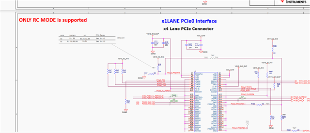

J784S4 EVM schematics can be referenced as it supports both EP and RC modes: https://www.ti.com/lit/zip/SPRR458
Takuma
1、Does TDA4VEN EVM support EP mode?How to modify the TDA4VEN EVM to support EP mode?
2、I previously saw a post describing that the TDA4VEN EVM does not support modifying the EP mode. Is this correct? If a custom board is later based on the TDA4VEN platform, how can the EP module circuit be added? The link is as follows: e2e.ti.com/.../tda4ven-q1-transmitting-video-streams-between-two-tda4vens-via-pcie
Hi Quansheng,
The TDA4VEN SoC supports, but not the EVM. The J784S4 EVM has a note that says which resistors must be connected/disconnected depending on EP/RC mode which can be referenced for TDA4VEN custom board.
