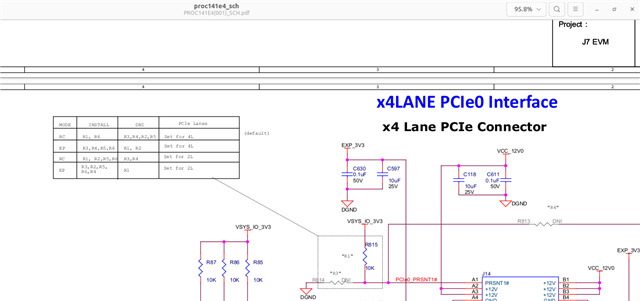

  • Hi Yangtian,
    As an example from the J784S4 EVM schematic file, there are some resistors that can be easily modified to change the PRSNT signal behavior of the PCIe port.
    TDA4VEN EVM does not have the disconnected DNI pads to allow the board modifications.
    Takuma
