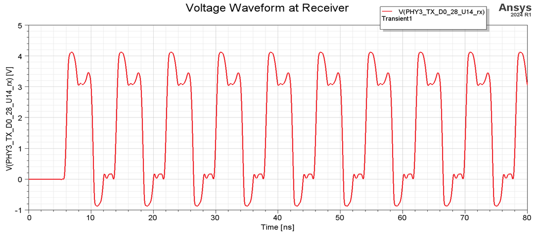

While simulating with the Ethernet GMII Section of DP83869HMRGZR , i am seeing certain overshoot and undershoot in PHY_TX_D0,PHY_GTX_CLK. Attaching the screenshots below . Can you explain the reason ??

Thank you for the simulation schematic.
We tried simulating it on ADS. Below is our schematic with impedance control '1111':
And you can see the overshoot:
With higher impedance setting ('1001'):
You can see that the overshoot is gone:
