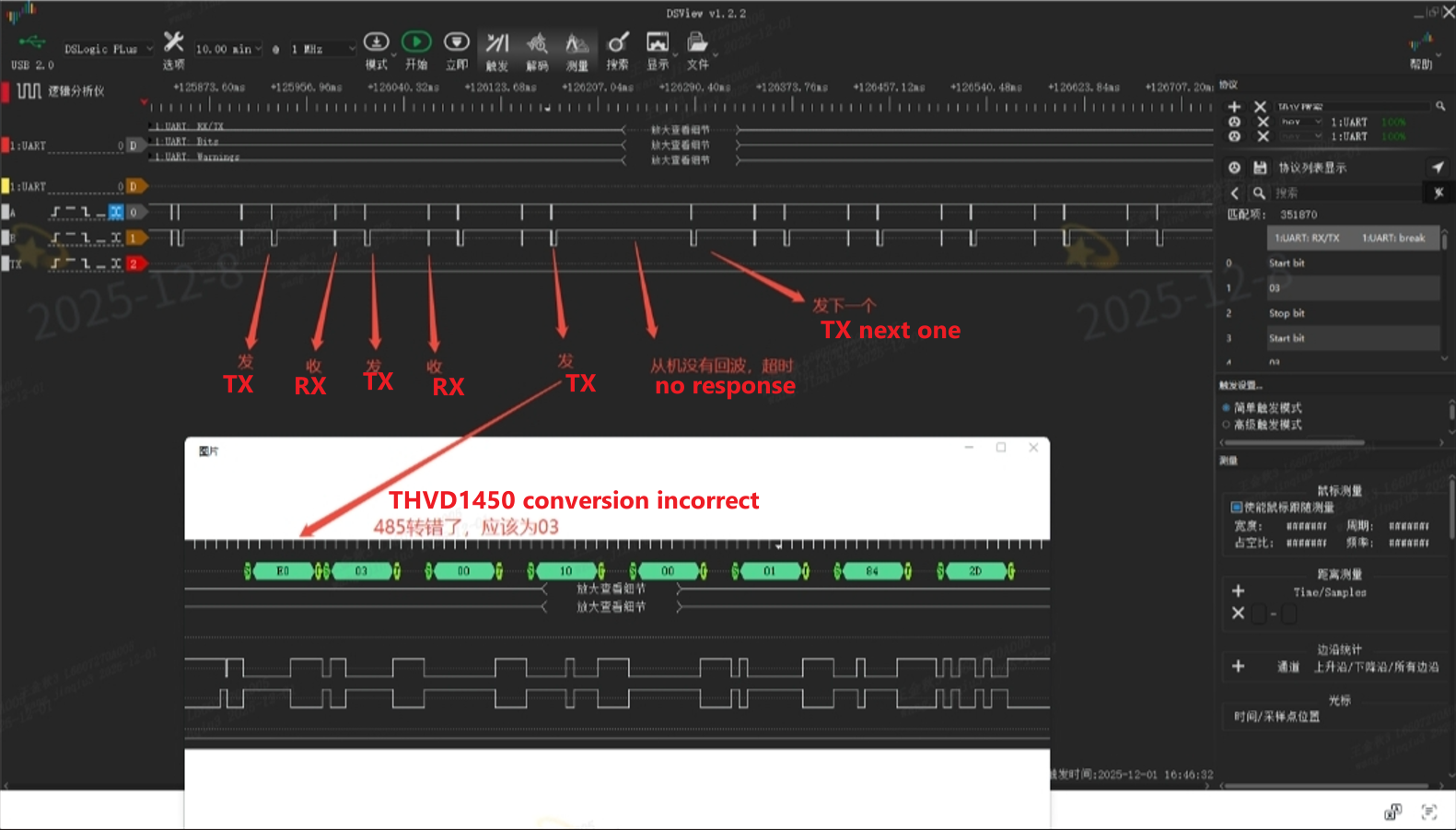

Hi team,
The communication works normally when the THVD1450 is used between the MCU and a single slave device. However, intermittent timeout issues occur after adding a second slave. Through waveform capture, we confirmed that the serial data sent by the MCU is correct, but errors arise after the data passes through the THVD1450.
Key configuration details are as follows:
- Termination resistor: 120 ohms
- Baud rate: Initially 115200, later lowered to 19200 (no improvement observed)
Could you please help analyze the various potential causes of this issue? i would also appreciate guidance on the direction for debugging.

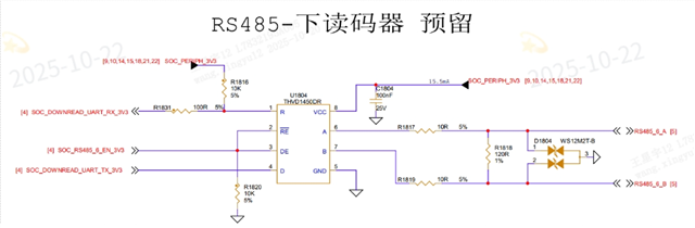

  • Eileen,
    Do you have a schematic of the system? (Of each RS485 transceiver)
    Do you also have a block diagram of what the bus looks like?
    -Bobby
  • Hi Bobby,
    Please check the schematic below.
    Draft block diagram of RS485 bus:

  • Please check the schematic below.
    I don't see any issues with the schematic. The 10 resistors on A/B can weaken the drive strength of the device (limiting the max distance and datarate) but I don't immediately think this is the issue.

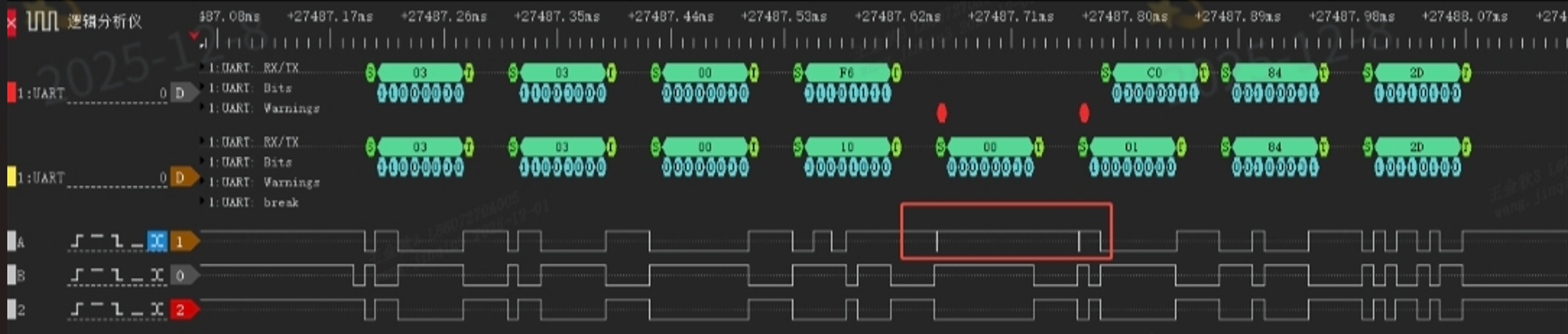

    BUS waveform from scope when communicate normally:
    Can you get a scopeshot using the math function of A-B of both the passing and failing waveform?

    A-B of passing waveform:

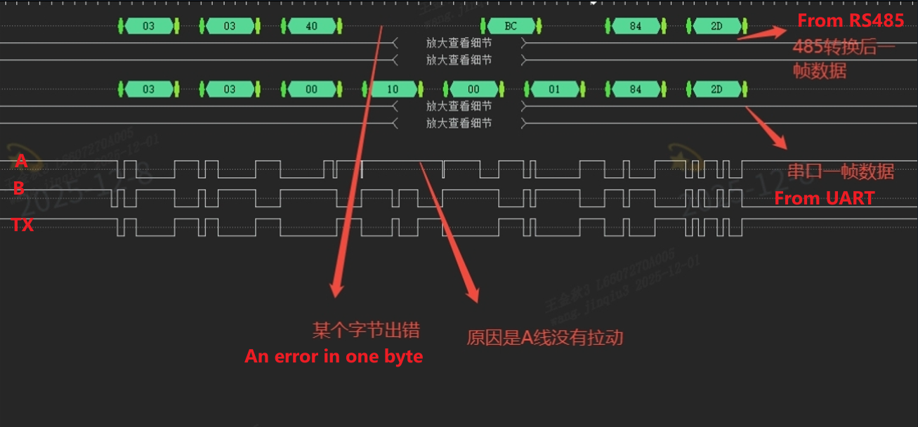

    The waveform shown in the main body of my post is the abnormal signal acquired via the logic analyzer. Owing to the technical limitations of the customer’s equipment, capturing this specific abnormal waveform with an oscilloscope remains challenging for their team.

    I need to see the A-B signals of the failing waveform to understand if the issue is analog related (to our device).
    Is it impossible for us to look at the A-B scopeshots on either the main customer board or the Radar modules?
    The customer reported that they couldn’t capture the abnormal waveform with an oscilloscope—extending the time base would lead to distortion, and the constantly toggling communication signal cannot be triggered. Or could you share an effective oscilloscope capture method?

  • Without scopeshots all I can do is guess.

    Again, without scopeshots I will be making random guesses. Here is a list of guesses.... (Also note, I am not able to find an English datasheet for that WS3080 device so I am using the Chinese one and making some guesses)
    1) If there are any termination resistors on the radar module, remove them. If multiple boards have 120 ohm resistors, that will cause the VoD to become smaller and make it harder to detect/see the transmitted signal. WS3080 has a ViD of -200mV for a logic low and requires a ViD of 10mV for a logic high. If there are 3x 120 ohm resistors in paralllel, this would make the resistance 40 ohms. The VoD of our driver will get smaller as the parallel resistance gets smaller.
    2) Our device's fast rise/fall time is somehow causing the WS3080 to trigger its esd protection. Try sampling a THVD1400 and see if the issue still persists. THVD1400 has slower rise/fall times which could be helpful if this is happening.
    3) Similar reason to above but placing a cap in parallel with the 120 ohm resistor (you can just populate it on top of R1818) can slow down the edge rates and help with any kind of edge rate skew between A/B. Try 1nF.
    4) replace the WS3080 with THVD1450 just to check and see if it's related to the transceiver or the board.
    5) replace THVD1450 U1804 to verify if the device is damaged.
