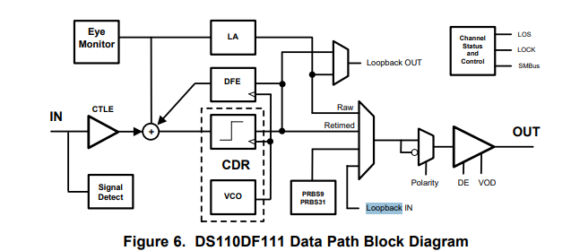

DS110DF111: Loopback raw vs retimed data
Part Number: DS110DF111
The block diagram in section 7.2 of the datasheet shows that you can output either raw or retimed data to Loopback OUT. However, I do not see a register that allows you to control whether it is raw or retimed data. Is this something the user can control? If so, how?
Thank you!
